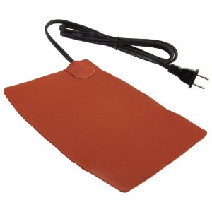

Fort Mac? A battery pad heater may be a good idea too. I think a charger will keep the battery somewhat warm, but a battery pad heater is effective and inexpensive.

Battery Pad heater....is that like a battery blanket? I'm going to a camp job so my van will be sitting around and not being driven. Was gonna fire it up every Sunday (my day off).

Sort of:
It sits under your battery, so if you can plug in your block heater, you can plug in the pad too, and it keeps the battery warm.
