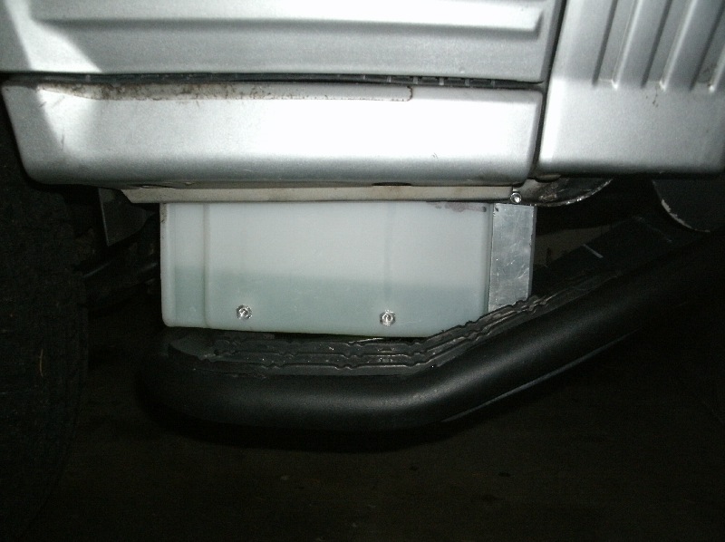

I had already relocated my auto transmission cooler so I was able to use the free space to mount my injection tank. I designed the aluminum mounting straps to allow the tank to "hinge" down to slide the tank out to fill. One wing nut secures the entire thing....waaaay over built, but cool (I think) none the less.
The tank is in the coolest spot it could possibly be mounted(..get it?? lol) access is quick/clean and easy for filling. I mounted the one nozzle on the EGR block off plate on the intake manifold, as it sees the most turbulent air flow and can spread the mixture evenly amongst the cylinders...works well. It did lower the EGT's by over 200*. I currently have it set at 10psi.

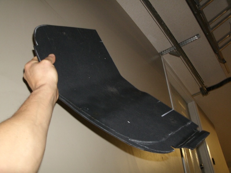

I designed a cover plate out of ABS which I molded with a heat gun. It affixes using the same wing nut as the mounting straps.
More aerodynamic than before...if you could call it aerodynamic!!

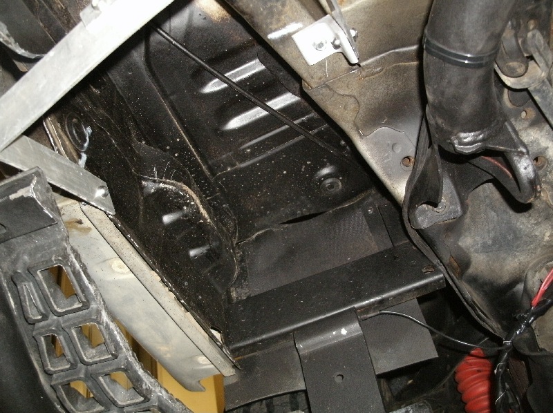

..uber space without the old trans cooler

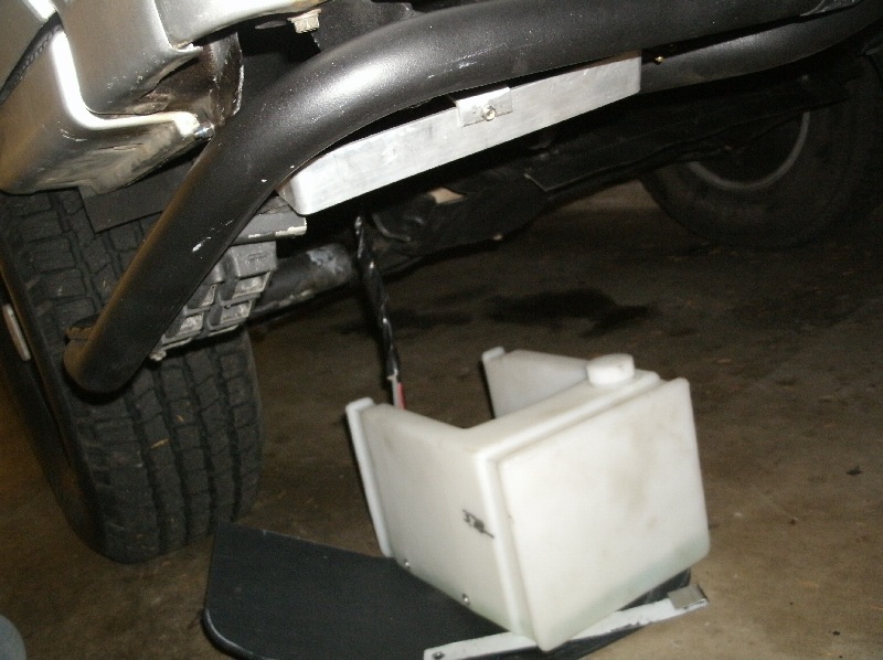

The whole thing simply slides out onto the ground for refilling...no messes to worry about.

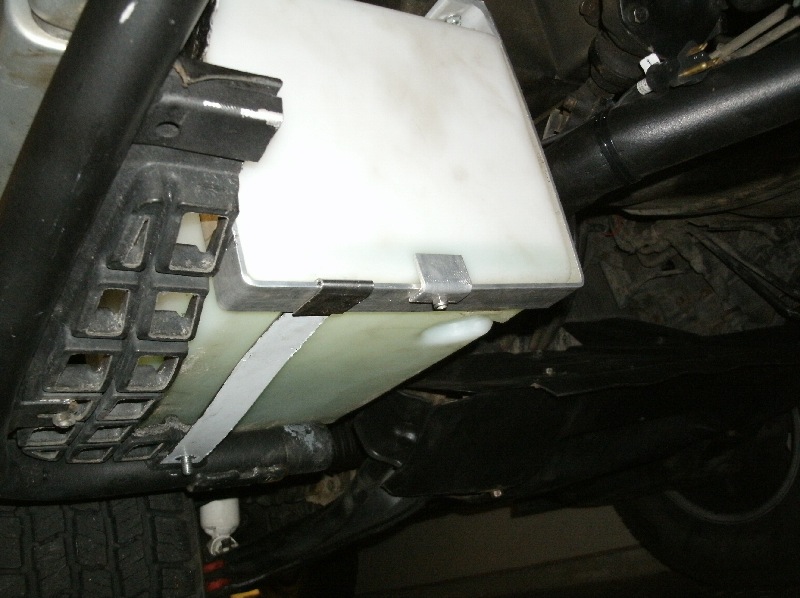

..good old 1/4" ABS sheet to the rescue again,  between the tank and the cover, should be good for a few good hits!!
A little overkill on the straps, but I seem to have an abundance of aluminum and stainless around.  Note the use of the step mounting bolt for the strap anchor.  The tank "rests" on the rear of the step.
