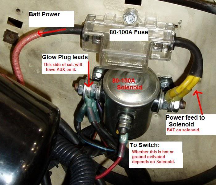

I was actually wanting to bypass the relay all together and do away with relay ecu and anything else that will ultimately give me grief down the road. I had a small diesel in a sailboat with pushbutton glow plugs I loved the simplicity of that engine, I realize that doing it manually you risk burning out plugs etc. but if done right is it not more practical, any comments on the pros and cons of this are welcome. Here is a pic of a setup I am aiming at.

Or just run a wire directly from the battery to a switch to a set of 12v plugs.

Should have a relay as 60amps is lots of power (need a big wire, (should have fuse/breaker since 60amp wire will burn the delica down if it shorts)) and a 60+amp fuse.nxski wrote:Or just run a wire directly from the battery to a switch to a set of 12v plugs.
You can also wire an amp meter in to let you see if a glow plug stops working...
