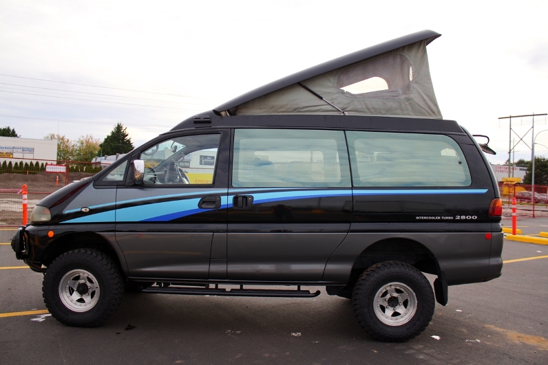

Once that poptop gets shined up that will look mint! I hope you bring it to a meet in the fall...

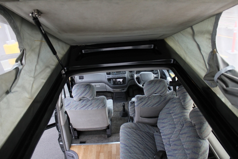

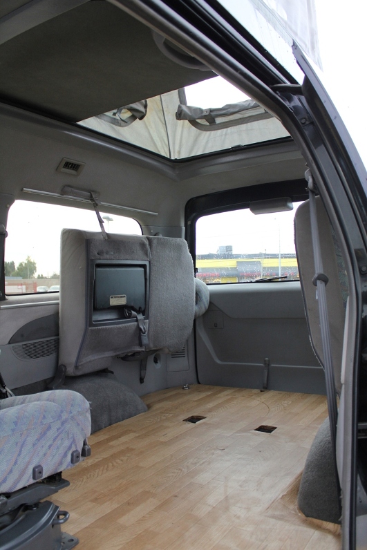

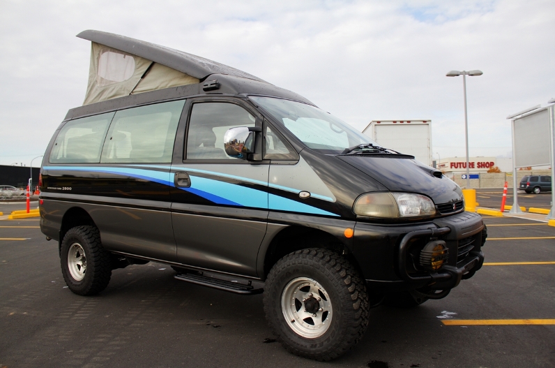

here you go CraigCREGAN wrote:Awesome! I have been waiting for an update on this bad boy. Show us more!! Health permitting of course![]()

HOLY CRAP! That looks amazing Jesse- well done. Show us more!

The more I drool over these pictures, the more I love that stripe on the side. It looks retro and sweet!

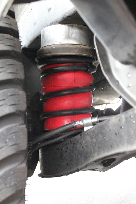

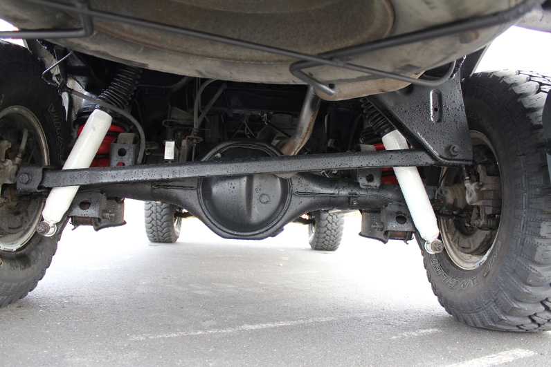

Here you go. I got the number from supafox. Here's his thread : http://www.delica.ca/forum/which-spring ... 49-15.html
Here's the airbag kit : http://www.summitracing.com/parts/AIR-61792/
You don't have to remove the springs to install the airbags. Found a neat and easy way to install them on a hoist. Fold it lengthwise in half, then fold the two tops inwards like a burrito. Then stuff it in and unplug the air plug and connect to air/inflate. About 30 mins per side. I routed each air hose forward under the lower control arm and up where you can see the filler nipple in the 2nd last picture.
If you have a lift kit already installed, you do not need to use the top supplied spacer as it will give you an additional 1.5-2" inches of lift. Van would look pretty 70's
