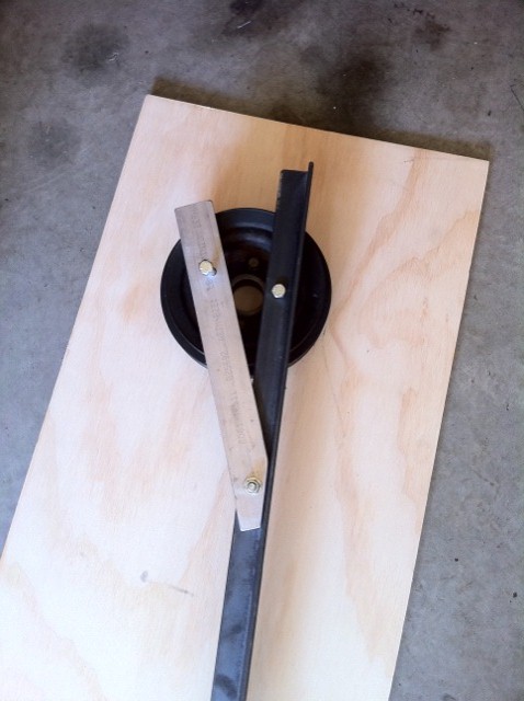

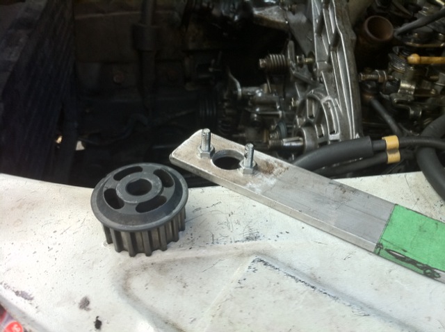

Crank and balancer pulley tools , maybe a little ghetto but should do the trick.

Balancer pulley tool

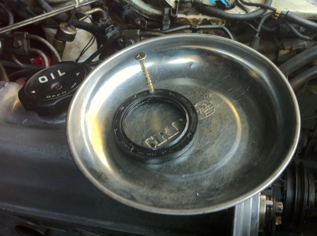

Great way I found to remove old oil seals, drill a small pilot hole in the metal portion of the seal turn a screw in and pull it out with pliers, without damaging any of the mating surfaces .
