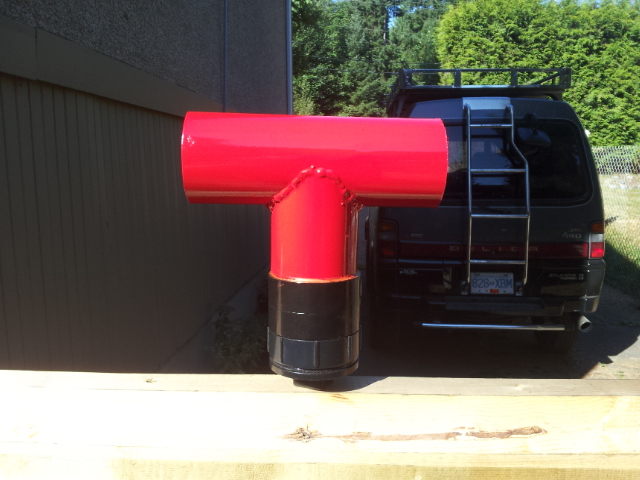

Well it started with finding of building a snorkel kit but I could not get over the hole required to the side of my delica. So I then explored other was to get cleaner air and a bit of rammed air effect. Looking around my air box I noticed what looked like a air duct missing. So I did some research on the sight and came up with opinions of why it should not be there and pics of delicas with the hose in place. Well time went on and driving gravel roads 1-2 times a month I was finding my filter would plug almost every 5000km and performance would suffer greatly. So back to the drawing board enough was enough. I then went looking through three different manuals at the air intake system and behold it showed a hose connecting the ducts in question. So here is my solution

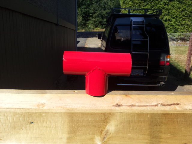

- 20120811_093749.jpg (199.61 KiB) Viewed 5099 times
- Welded and painted pipe together

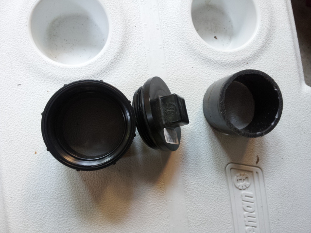

- 2.5" abs adapter and cap
- 20120811_090112.jpg (199.18 KiB) Viewed 5099 times

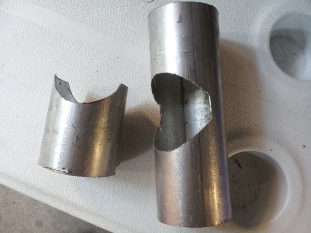

- 2.5" exhaust pipe one piece cut 7" long the other 3" long and then notching thwm together in the middle.

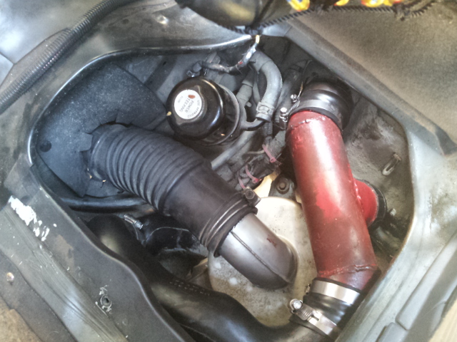

Well It was tight and I had to add 45° angled pipe to each end but it fits with a clean out on the bottom. No time will tell if it was worth it.

Just got back from a drive with the new air duct and there is a noticable drop in EGT above 80km cruising on flat ground at 100km temps are around 700ish. But the biggest thing I noticed was how fast the EGT drop when you let off on the throttle. So there is no doubt a ram air effect. Which should make the clean out valve on tue bottom of the filter canister work a bit better.
