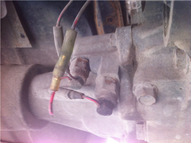

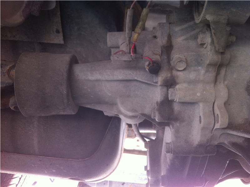

So my 4wd light doesn't work, and after a bit of searching I found the culprit. The 4wd sender plug near the transfer case has a broken wire. It's broken right at the plug, so there isn't enough wire to splice them together.
Where can I get a new plug? Actually, there's two plugs and I should replace them both since the wires on the second are also pretty frayed.

Re: 4wd sender plug
Remove the switch,gently broke the black plastic and you will see where the two wires are
soldered.replace the wire witn new one,solder it and glue it with hot glue gun.
Sure,it's not a new switch but it will work again like a new.

Re: 4wd sender plug
Right on.
That was what I was going to try at first, but knowing me I would break it worse..
I'll giv'er a try later this week and see what happens.
