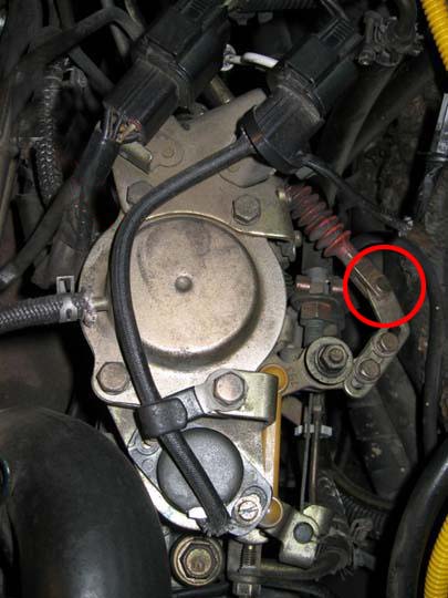

Check that the pin (circled in red) hasn't come loose. It's held by a tiny split pin that usually rusts away and releases the linkage.
Injector Pump.jpg (57.67 KiB) Viewed 8007 times

Tojo wrote:Check that the pin (circled in red) hasn't come loose. It's held by a tiny split pin that usually rusts away and releases the linkage.
That was it!! THANK YOU Tojo!!
Put a long machine screw in and a double nut to ensure it stays in.
Thanks everyone!!
