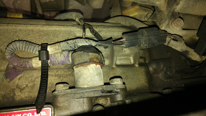

I'd suspect the OD solenoid on the gearbox isn't getting power.
EDIT: the wiring diagram I had is wrong. There's nothing electrical to prevent OD engaging when the transmission is cool. Instead there's a slight restriction in one of the hydraulic ports inside the transmission, and thick, cold fluid can't build enough pressure to engage the OD. It's simple and dumb.
The wiring diagram alleges that there's a coolant temperature switch that only lets it operate once the engine is warm. I have no idea where that switch is, but it sure seems to work that way. Anyway: with the ignition turned on and engine warm (but not actually running) if you climb under the van you should be able to hear the solenoid clicking if someone in the cab turns the OD button off and on. (I'm guessing the OD off light on the dash works.)
If you can't hear it clicking in and out, I would try applying 12V directly to its connector. If it clicks then, I would leave it connected and go for a drive to confirm that you have 4th- and then figure out where the break in the wiring is. Once the engine is warm, the gearbox should drop into 4th at about 55kph if you're being gentle.
The TPS doesn't do anything gearbox-related. It's there for the glow plug controller only.
The full throttle kickdown cable adjustment (that 32mm one) mostly effects full-throttle gear changes. If your 1st-2nd shift is playing up, check the cable adjustment at idle (1-2mm free play). That said, 1st-2nd is always a bit mushy, it can take about a second to complete the shift if you're driving normally. 2nd also does this weird thing where it feels like it's slipping, but locks up if you put your foot down a bit harder. I have no idea what it's doing, but they all do it to some extent.

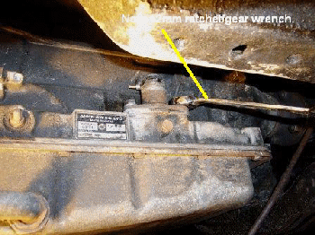

Dirt. [Rob Bareiss] Replacing the solenoid requires that NO dirt get in that transmission. Lots of brake cleaner, Gunk, power washing, and probably use of a toothbrush and more brake cleaner will get the area acceptable. You might follow up with compressed air delivered by a J-tube to remove dirt and little rocks lodged up behind the solenoid. Haynes suggests the use of a sheet of cardboard over the trans, up against the tunnel to keep grit from falling in from above. Dirt and transmissions disagree.
Don't get any dirt into the solenoid when you replace it. This is a filthy area and it's easy to do this. The plumbing internal to the solenoid unit, which has a right angle turn at the valve seat, can plug up. You may have to pull the OD solenoid, rig it up to the battery to turn it on and blow it out with WD40, carb cleaner, compressed air, or any similar pressure source, preferably with a little straw to get down into the holes.
[Editor] Two users reported that removing the solenoid and turning the engine over seemed to pump enough oil through the recess to clean it out and enable operation. This is messy, though. [SML] Before re-installing the solenoid, clear the oil passages in the transmission by slipping a tray under the tranny, starting the car and quickly shifting the auto trans gear lever from P through R,N,D,2,1,P then quickly off. About a 5 second process. A flood of trans oil will squirt out from the car hopefully clearing any blockages.
[C. McGrew] My transmission was leaking fluid and was oil soaked from an engine rear main seal leak. The solenoid rubber cap becomes brittle and then it's good bye. Be sure to buy the two o-rings for the solenoid. Coat o-rings with plumbers or silcone grease for sealing and ease of install. It's not that bad getting your fingers in the correct position to replace the two bolts. Re-torque to 7-12 ft-lbs to tighten the solenoid bolts.
Rusted Bolts. [James Souther] If the solenoid mounting bolts are rusted, the lockwasher is only rusted to the solenoid flange and the bolt head, not in the threads as the case is aluminum so PB Blaster or Kroil will help but not solve (no pun intended). If you use penetrants, use starting fluid or brake cleaner to clean off around the solenoid base before you start as both dirt and penetrants are not good for the inside of the transmission. Second, free the solenoid wire cable and the brackets before trying to loosen the bolts. This lets you get better access if you flop that out of the way. If needed you can take the nut off the shift shaft input and move it away, however, you need to hold the lever so you do not stress against the transmission valve assembly inside. The lever goes on with a rectangular notch. Third, attack the bolts which set very close to the solenoid body and come out by hand after a turn or two. IMHE the original bolts seem way overtight due to being threadlocked so what works is a quarter inch 6 pt socket with extensions to get down on top of the bolts or a thin box end wrench and lots of force. The posture is pulling the car and the wrench or ratchet together so you can put enough force on it. In a dozen or so times, the bolts mostly "crack" loose. When you get it out, check to make sure the old o-rings are not stuck on the transmission flat. Finally, take heart, installation is a breeze compared to taking it out.

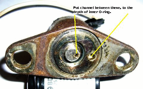

[E. J. Ohler] Forget about a new $150 solenoid and $50 relay: take the solenoid out, cut the wire off and cap the end, grind a small groove between the center hole and aft hole in the solenoid face, and reinstall to allow fluid to move and disable the solenoid as a solution to solenoid troubles. Use a Dremel 1/8 inch grinding tool (the metal is hard so you will use two) or a diamond bit. Clean the matching holes in the tranny using drill bits the same diameter, but don't drop them into the transmission. Replace the outer O-ring but not the inner where the groove passes through. From start to finish this is a 3 hour job that saves you a lot of headaches. You don't need the manual 4-3 downshift in most instances anyway.
Solenoid with Ground 1/8 Inch Groove

[John Orrell] there is a almost free way of doing this. Remove the stock solenoid, remove the inner O-ring and machine/grind a groove in the face of the solenoid between the two small holes. Replace the outer O-ring (not exactly free, but cheaper than 39.95) and reinstall the solenoid.

Hey! So I checked the wiring and there was power to the Solenoid with engine warm and ignition on.
I suspect this means that the Solenoid is toast? My dash light works fine.
I'm going to check RMI and see what they have.
Re: Ain't Got No (satisfaction) Fourth Gear
Posted: Thu Aug 25, 2016 10:14 am
by Growlerbearnz
That's the conclusion I'd draw as well. Replace the solenoid and keep your fingers crossed. Could you hear it clicking as it was turned off and on? I mean, it might be physically jammed so it'll click but not actually do anything, but if it was silent then that's definitely a problem.
