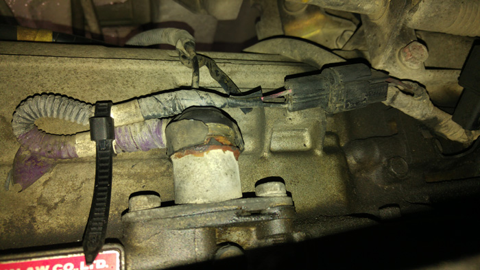

I'd suspect the OD solenoid on the gearbox isn't getting power.
EDIT: the wiring diagram I had is wrong. There's nothing electrical to prevent OD engaging when the transmission is cool. Instead there's a slight restriction in one of the hydraulic ports inside the transmission, and thick, cold fluid can't build enough pressure to engage the OD. It's simple and dumb.
The wiring diagram alleges that there's a coolant temperature switch that only lets it operate once the engine is warm. I have no idea where that switch is, but it sure seems to work that way. Anyway: with the ignition turned on and engine warm (but not actually running) if you climb under the van you should be able to hear the solenoid clicking if someone in the cab turns the OD button off and on. (I'm guessing the OD off light on the dash works.)
If you can't hear it clicking in and out, I would try applying 12V directly to its connector. If it clicks then, I would leave it connected and go for a drive to confirm that you have 4th- and then figure out where the break in the wiring is. Once the engine is warm, the gearbox should drop into 4th at about 55kph if you're being gentle.

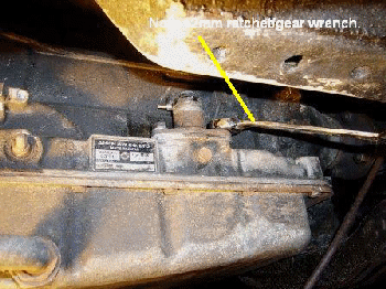

Rusted Bolts. [James Souther] If the solenoid mounting bolts are rusted, the lockwasher is only rusted to the solenoid flange and the bolt head, not in the threads as the case is aluminum so PB Blaster or Kroil will help but not solve (no pun intended). If you use penetrants, use starting fluid or brake cleaner to clean off around the solenoid base before you start as both dirt and penetrants are not good for the inside of the transmission. Second, free the solenoid wire cable and the brackets before trying to loosen the bolts. This lets you get better access if you flop that out of the way. If needed you can take the nut off the shift shaft input and move it away, however, you need to hold the lever so you do not stress against the transmission valve assembly inside. The lever goes on with a rectangular notch. Third, attack the bolts which set very close to the solenoid body and come out by hand after a turn or two. IMHE the original bolts seem way overtight due to being threadlocked so what works is a quarter inch 6 pt socket with extensions to get down on top of the bolts or a thin box end wrench and lots of force. The posture is pulling the car and the wrench or ratchet together so you can put enough force on it. In a dozen or so times, the bolts mostly "crack" loose. When you get it out, check to make sure the old o-rings are not stuck on the transmission flat. Finally, take heart, installation is a breeze compared to taking it out.

Hey! So I checked the wiring and there was power to the Solenoid with engine warm and ignition on.
I suspect this means that the Solenoid is toast? My dash light works fine.

That's the conclusion I'd draw as well. Replace the solenoid and keep your fingers crossed. Could you hear it clicking as it was turned off and on? I mean, it might be physically jammed so it'll click but not actually do anything, but if it was silent then that's definitely a problem.

Ya, it was silent as I had someone flicking the button. I also gave it a few 'love taps' from a wrench but nothing shook free. :) Sure hoping for 4th gear sometime in the near future.

Hey! Great news! I've got 4th Gear, wahoooo!!! It was the OD Solenoid. Such a small little thing affects such a major issue. Pulled one off a wrecked L300 and was quoted over $300 for a NOS part.
