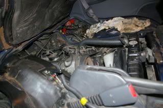

But the main concern is a small plastic part I broke while screwing the last two bolts :shock:
I think it is a part involved in the fuel distributing process because the black flexible tubing it is connected to runs from the fuel injection pump towards the rigid lines on top of the valve cover gasket (or the other way around, I ain't sure). It also has a wire connected to it, so it could be some sort of valve (a 2 way valve?) Here are some pictures to get a better idea.
As you can see on the second picture of this serie, I bypassed the broken part (look at the green X on a black tubing). I made this to test if the engine was still working properly after changing the belts (and it did!), but after running for about 15 minutes (the time to get back home from the friend's shop where I did the work), i found that the engine was idling at a higher rate than when I first started it (say: Regular idle rotation, around 850rpm. When the engine is warm, around 1250rpm). Also, when I shut the warm engine, I hear a sound during a few seconds, as if the turbo was letting an excess of air out. I double checked later tonight and it did the same.

The part is the vacuum solenoid for the A/C idle speed increase.The reason you idle speeds high is because you are applying vacuum straight to the diaphragm on the fuel pump as you have bypassed the solenoid.

Try disconnecting and plugging both ends of the vacuum hose first. If the solenoid is for A/C idle-up it likely applies vacuum to the injector pump when the A/C switch is turned on. It's like a switch that turns the vacuum on and off. This means that by hooking the vacuum hose directly to the IP you are idling-up the engine as if the A/C were turned on.

originalkwyjibo wrote:Try disconnecting and plugging both ends of the vacuum hose first. If the solenoid is for A/C idle-up it likely applies vacuum to the injector pump when the A/C switch is turned on. It's like a switch that turns the vacuum on and off. This means that by hooking the vacuum hose directly to the IP you are idling-up the engine as if the A/C were turned on.
Thanks originalkwyjibo,
I'll check that out in the next days: If I understand properly, you suggest to unplug the hose while the engine is running to see if its speed will decrease and than stabilise around 850rpm, showing that bypassing the vacuum solenoid provoques idle-up. If it works that way, than I can probably block both end of the hose to prevent from getting clogged, and wait until I get a new solenoid without using A/C meanwhile.

Posted: Mon Nov 15, 2010 10:35 am
by CVI
