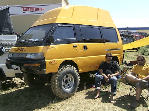

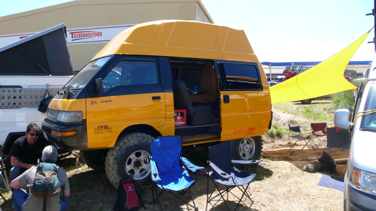

Also think of the extra weight a hightop fiberglass would add on there with gear.
Felix posted a youtube clip of a yellow lifted L300 with a hightop I believe. It tipped over on it's side while the camera man expressed the 'S' word in German. :-D

Posted: Sun Feb 07, 2010 11:21 pm
by Luna-Sea
Hey,
This is the big yellow beast in question.
http://www.youtube.com/watch?v=cMtSape57rU
Anyways, these are a few pics of it I found in one of my
caffeine hazed delica searches,you can see the top a bit
more and there is a bit of an interior view.
I think these pics were taken soon after the vid
,note nice dent in the port quarter!
Looks like the made sure they brought enough beer too. :-D

I personally think the sail area would be scary and awful in a good crosswind,
especially on a lifted unit.

Would be interesting what tire and lift size they are running. Looks like they just can go in a straight line 8-)
