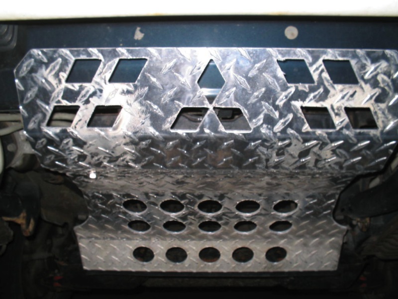

I don't mean to be overly critical, but the first thing I noticed about the skid plate everyone bought this past year was how it seemed to go all the way down to the 'scoop' in front of the radiator. And now that I've found the pictures, I've confirmed my suspicions. The double row of holes is at the wrong angle to allow enough air flow, and the lower single row of holes is too obstructive too.
Very nice looking, but covers the ram scoop for bottom edge of radiator.

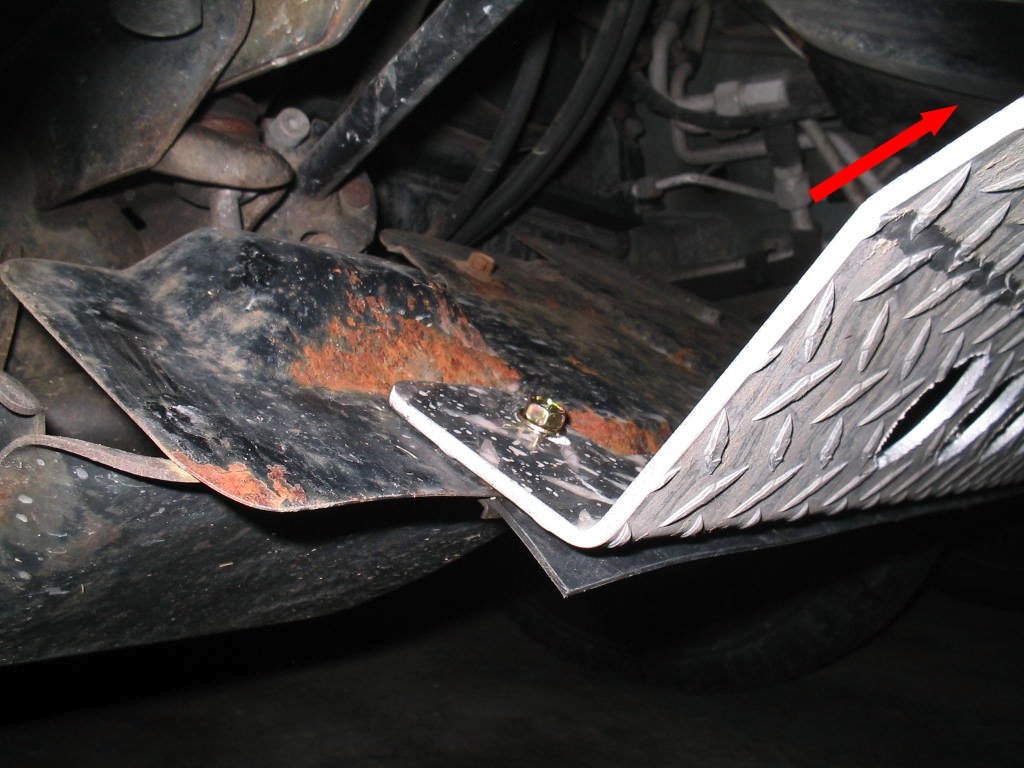

The red arrow in the next image indicates where most of the aftermarket skid plates end.
I suspect that this particular version doesn't allow enough air flow around the engine bay - might be the cause for your overheating.
Here are two others that either end before the ram scoop or have sufficient-sized holes down in what I am speculating is a critical area for air flow:

I have noticed that in this hot weather my temp goes up just above 1/2.I was driving from my work in Chilliwack back to Langley.When I get to Sumas & start climbing to Abbostford,temp starts to climb.Today I joined the holes together & took the Hope Princeton.I am now in Vernon & had no temp problems.Tomorrow going to Kettle Valley & then Banif.The pictures used in this section are of my van.The plate just needs some bigger cooling holes,easy to do,no big deal.
