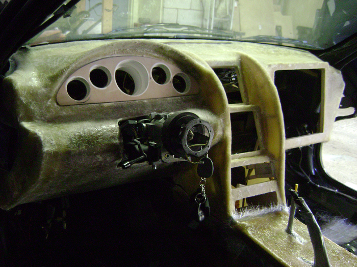

I was looking more at a full fiberglass dash like this...has anyone taken on a project like this?

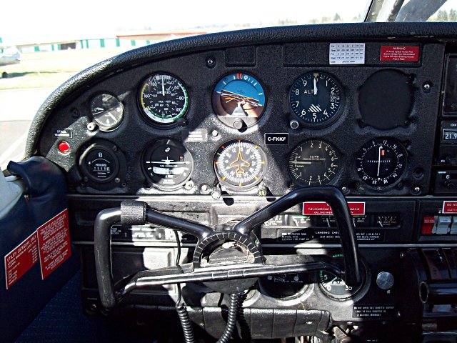

Is this enough gauges and switches?
...laura

I've done stuff like this before, it's not that hard if you've got the tools and know what you're doing (like everything in life) but you'll need a bunch of free time and your vehicle will be out of commission for quite a while. The biggest PITA is if you're painting it. There's alot of bondo sanding, then primer sanding, then paint sanding. Getting fiberglass smooth is not like getting sheet metal smooth and it's a heck of a lot of work. You'd be best off to stick to a textured finish or even upholster the finished product. The amount of sanding and ass pain increases with the number of little details and nooks and crannies in your dash.SnowBall wrote:Thanks for the ideas.
Also, for a while there during the sanding process you'll be the itchiest you've ever been in your whole life!

i like the compass in the center. id like to get one and mod the plane outline in the center of it to a delica...marsgal42 wrote:Is this enough gauges and switches?...laura
al

That's the heading indicator, a gyroscopic compass that supplements the magnetic compass that's out of the frame to the right. While it's immune to the turning and acceleration errors that affect magnetic compasses, it drifts slowly as Earth rotates underneath it, and you have to periodically re-sync it with the magnetic compass during flight.almac wrote:i like the compass in the center. id like to get one and mod the plane outline in the center of it to a delica...![]()
...laura

You Gotta love a lady that knows her way around an Airplane!!!marsgal42 wrote:That's the heading indicator, a gyroscopic compass that supplements the magnetic compass that's out of the frame to the right. While it's immune to the turning and acceleration errors that affect magnetic compasses, it drifts slowly as Earth rotates underneath it, and you have to periodically re-sync it with the magnetic compass during flight.almac wrote:i like the compass in the center. id like to get one and mod the plane outline in the center of it to a delica...![]()
...laura
