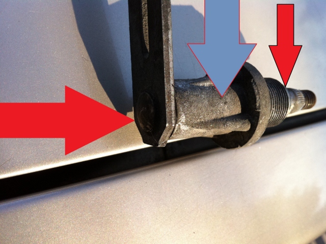

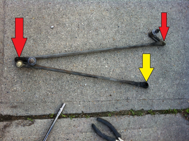

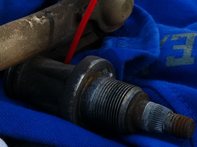

The quick fix was take wiper arms off and spray wd 40 on them then turn on and spray again this only lasts for a short time. So when it finally stopped raining i took the wiper motor out and the arms as well, the whole system apart. Just to find you can not take the rotating part apart. So got the drill and made a hole big enough to fit the jig a lube straw in. No more grinding or binding. I think will take it apart again and tap and die them so i can put a grease nipple, that should work best.

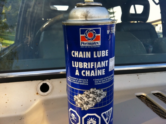

Well i made it through winter and the spring with my wipers not acting up. So i have redone them and lubed them with chain lube, all the joints where lubed, and drilled holes in the rotating parts and lubed that. It now works great in the rain.
