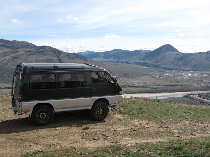

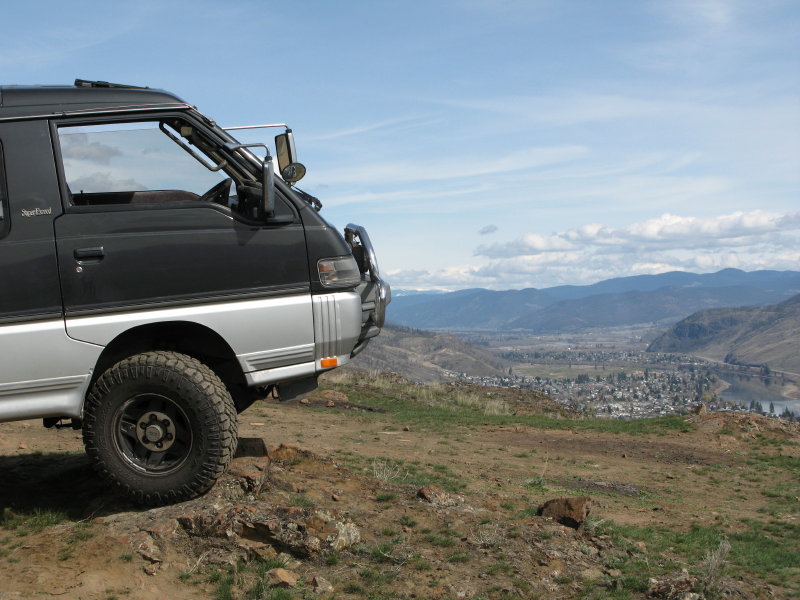

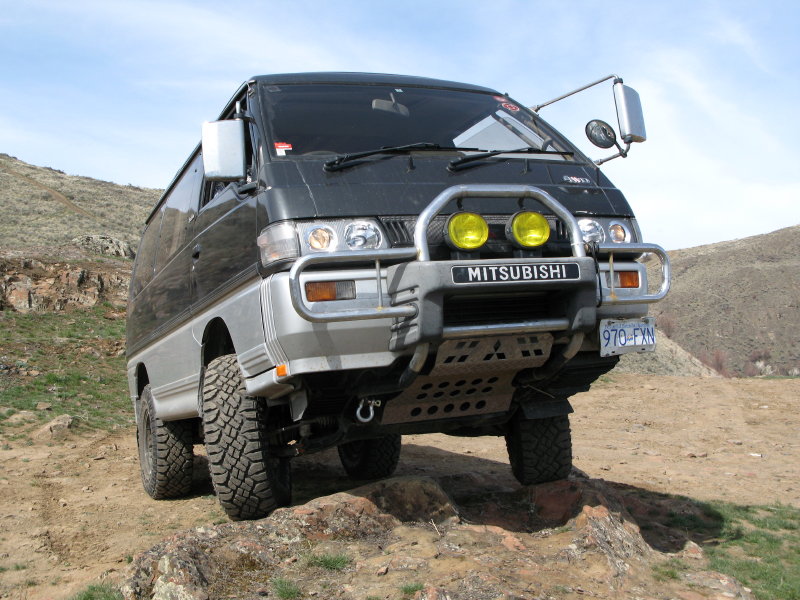

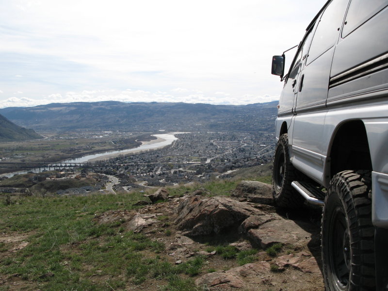

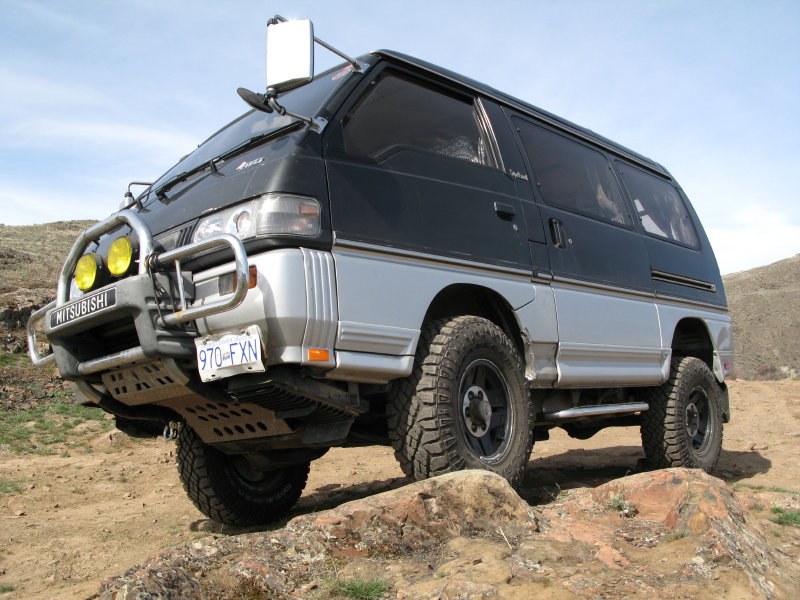

So, finally some pictures of my van, though I seem to have neglected including myself again! These pictures are all post-lift, post- new Goodyear Duratrac tires...
I meant to put some before/after pictures, but hey, we all know what a stock Delica looks like right? So without further adieu, here's introducing Honu II (Honu was a 1990 Blue/White Exceed- much prettier than Honu II, but lacking things like limited slip diff, and rear shoulder belts...) surveying her home territory of Kamloops, BC Showing off the new claws: Another view of the shoes- still some work to do putting on mudflaps, since this photo the wells have been rubberized undercoated though. And yes, like jfarsang mentioned in an earlier thread, these tires do fit HUGE. Even with cutting bashing, removing etc., there are still a couple rub issues (minor) Child #2 fast asleep after rattling up the trail to this spot. So, here she is- I do have some more photos to post regarding the lift and the tires, that I will have to do in the future when I have some more time. A massive huge thank you to jfarsang and Luna-Sea for heaps of assistance via telephone and PM's, and thank you to both of them for managing to find/build/send a lift kit so I could get these tires on!

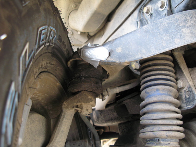

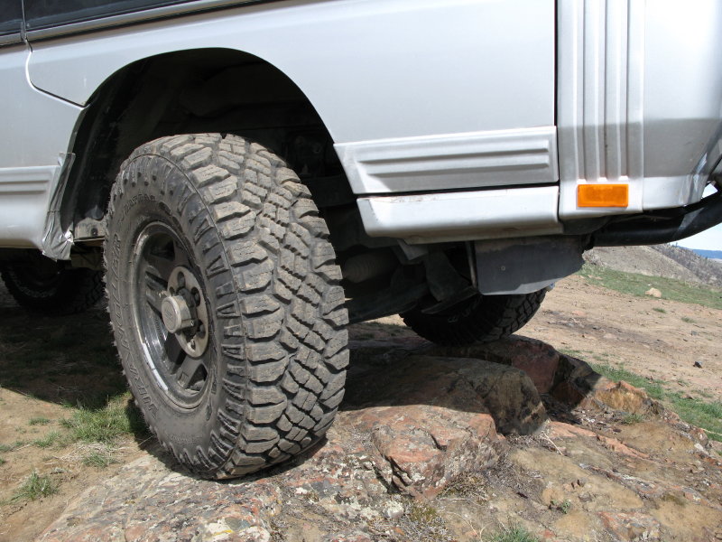

And when I mentioned about these tires fitting huge... here is a photo of where the upper A-arm sits in relation to the inside of the tire. These are 31" tires on rims that I bought from another trusted delica.ca member who also ran 31" tires on them with no such clearance issues. The tires don't quite rub unless cornering, and at least then it's a rounded edge (the paint has been cleaned off the side of the A-arm!)- but I think I will be looking for either some different rims with 1/4" different offset, or possibly the dreaded and much maligned spacers, again, just 1/4" thick- though I'd need to replace the lugs with 1/4" longer ones.
(the duct tape was to cover up the hole where the grease nipple goes, since at this point I had removed the old grease nipple to do the lift, but didn't have a replacement in there yet and I wanted to keep the crud out)
The tire lugs also brush against the sway bar in front of the tire if I crank the wheel all the way over ( so I try not to crank it!)
Pretty sweet tires though!

Wow, that's crazy (and dangerous too). You should get different rims asap. Do you air-down for offroading?jwfchase wrote:And when I mentioned about these tires fitting huge... here is a photo of where the upper A-arm sits in relation to the inside of the tire. These are 31" tires on rims that I bought from another trusted delica.ca member who also ran 31" tires on them with no such clearance issues. The tires don't quite rub unless cornering, and at least then it's a rounded edge (the paint has been cleaned off the side of the A-arm!)- but I think I will be looking for either some different rims with 1/4" different offset, or possibly the dreaed and much maligned spacers, again, just 1/4" thick- though I'd need to replace the lugs with 1/4" longer ones.

I haven't had to air down yet- and as for the rubbing- after a couple thousand km's so far, it has just barely rubbed the blueing off the raised white letters on the inside, but the letters themselves haven't been affected yet- so it definitely rubs, but no harder than brushing a curb on the outside- not that I'm trying to minimize the necessity of fixing the problem.

I ran those rims with BFG AT 31's and they weren't rubbing. Close but not quite there.
The duratrac's puff out more on 7" wide rims. That's why they run on the swaybar/arm.
The rim is a Toyota 15x7 4.75" backspace which is the same backspacing as a stock 15x6 mitsu rim.
Because it's just a hair of a rub at full lock, I would put 1/4" spacers.
Any more than 1/4" and then it will not be safe in my eyes.
With a 1/4" spacer, you will still have the turns needed on the stud threads for the correct torque for the wheels.
I've seen a number of L300/L400 and pajero's with 1/4" spacers.
Either that or get different 31's ... Just kidding

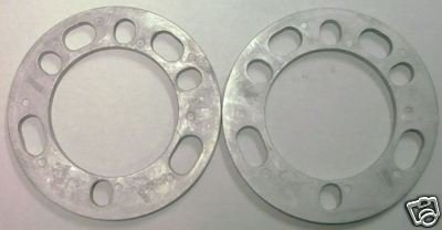

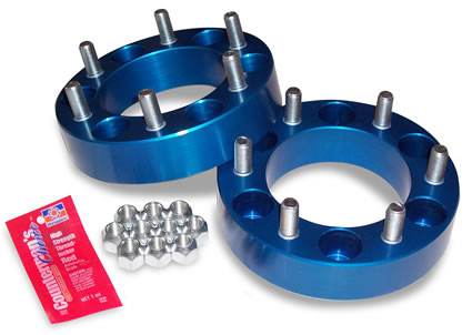

The 1/4 inch spacer would be a shim,like a "doughnut" with holes
that you use your stock studs as long as there are a lot of threads
left for the lugs to bite on.
Like these,just a pic I pulled off google For more than that the spacer is also called a "wheel adapter"
It uses you stock studs and lugs to secure a thicker "doughnut",
which has another set of Studs to Lug to.
These are lug centric toyota ones made by Spidertrax available
from North Shore Off Road,I am not sure if the hub centric ones would
fit better,but this is just to give you an idea.
I do know that both of these types need to be properly torqued and then re-torqued,
to ensure proper seating.

These ones warn that they should not be used off-road, but do these look right otherwise?
