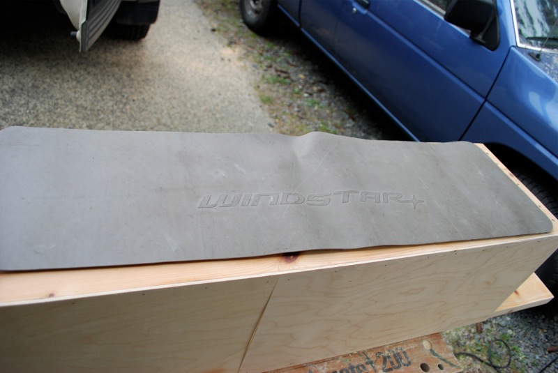

    -03 I've bad-mouthed NAMPOS in the past (probably will continue to), but this part of our Ford is the best thing from it: we used it in the back of the Moon Machine and now it's going to have a place in Monty.

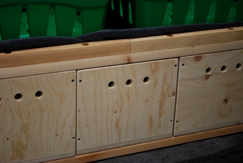

    -04 To keep the box from sliding around.

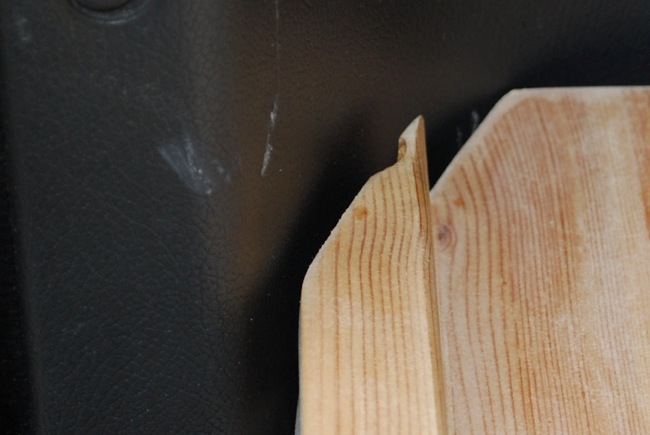

    -05 This was something I had to do afterwards. The top had square corners, but in order to get the whole unit to sit a bit farther back, I had to cut corners (as it were). Turns out, this makes it fit much better for the Superstore crates.

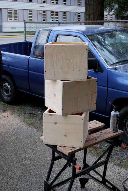

    -07 The boxes for the box. Promo shot, I know.

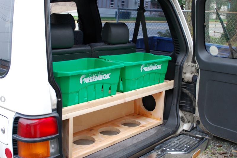

    -08 Where the boxes go. Another promo shot, yes.

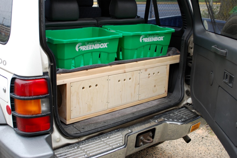

    -10 And this is what whole thing looks like. It does cover the jack storage in the starboard-aft wheelwell, but I'm hoping I don't have to access that too often. If I do, it's light enough to empty and then remove easily.
And that was my two-weekend project. It's a recycled kitchen table, half a sheet of 3/4" plywood, half a box of wood screws and some wood glue. As I mentioned earlier, I quite happy with this and the only thing I want to add is some felt to the corners that touch/rub against the corner of the cargo area.

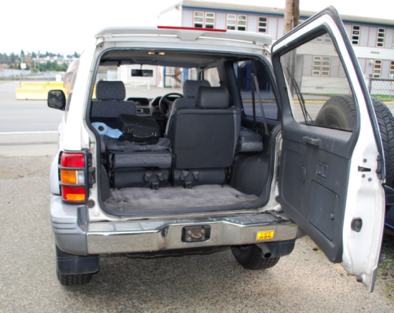

01 Where it goes.jpg (137.68 KiB) Viewed 2457 times

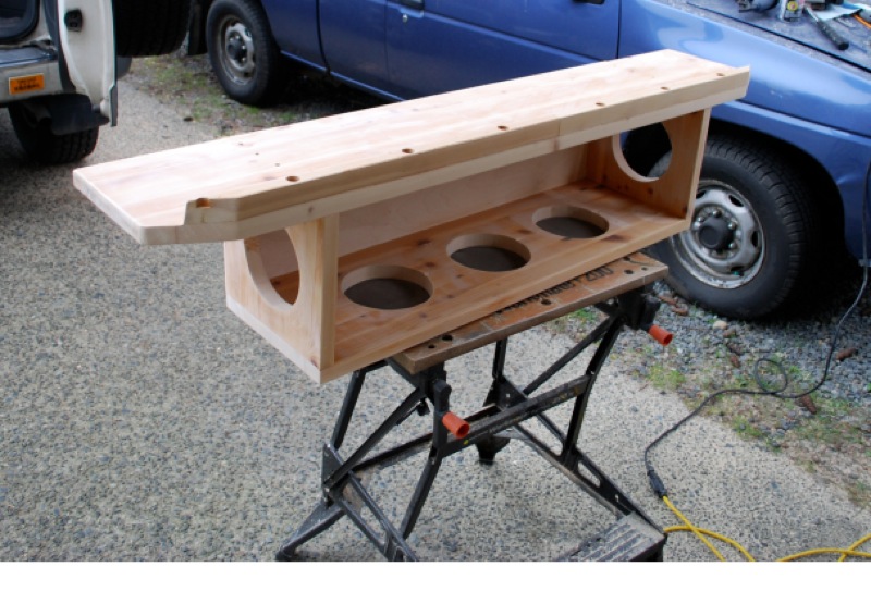

Holes are to cut down on the weight. The table-top used is 1" thick, quite heavy. The holes made a difference of a couple of pounds!
02 Finished product.jpg (143.78 KiB) Viewed 2458 times
All that remains of our '99 Ford Windstar - the best part of that whole gorram vehicle!
03 Left-over Windstar.jpg (92.03 KiB) Viewed 2458 times

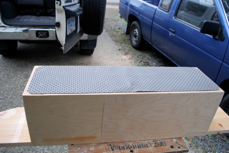

Nothing worse than a sliding box.
04 Rug catcher.jpg (121.12 KiB) Viewed 2458 times
This diagonal gained me about four inches.
05 Corner cut.jpg (58.63 KiB) Viewed 2458 times
07 Three stacked boxes.jpg (139.7 KiB) Viewed 2457 times
08 Three boxes.jpg (111.21 KiB) Viewed 2457 times

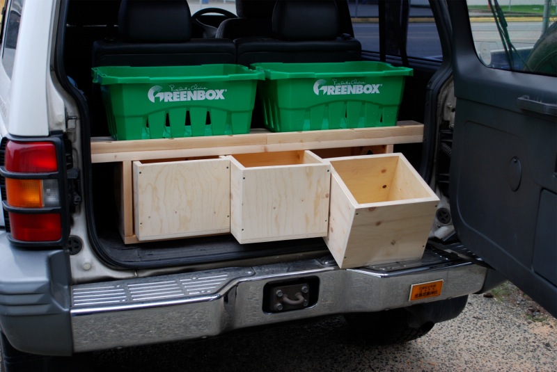

Voila!
Voila!
10 Complete arrangement.jpg (123.9 KiB) Viewed 2455 times

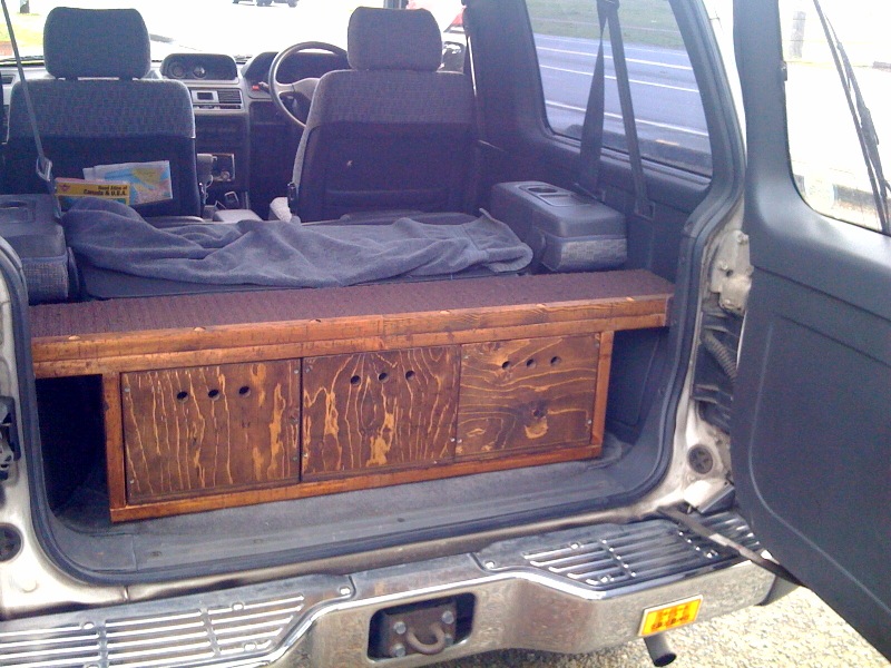

Re: Monty's Box - and now with stain!
The final step was to stain the boxes and to put some carpet on the top (and around the edges where it will rub on the walls). Here's the finished product.
Image taken with my iPhone
