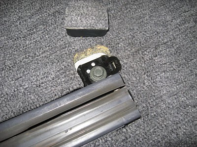

The rear 14 mm bolt holding the second row seat track in place provides an option for a car seat tether anchor. The bolt is hidden by a carpet plug.
There is an L300 thread on this topic where the tether was attached under the seat but the L400 has plastic completely surrounding the base.

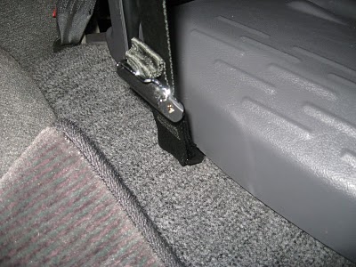

Anchor installed.
Tether attached to anchor.
Incidentally, the car seat manual for this particular model warns that if the seat belts originate forward of the seatback/seat bottom crease (which they do on an L400 captains' chair), a locking clip must be used. It might be a good idea to take a close look at your manual to find out what is safest for your kids.
