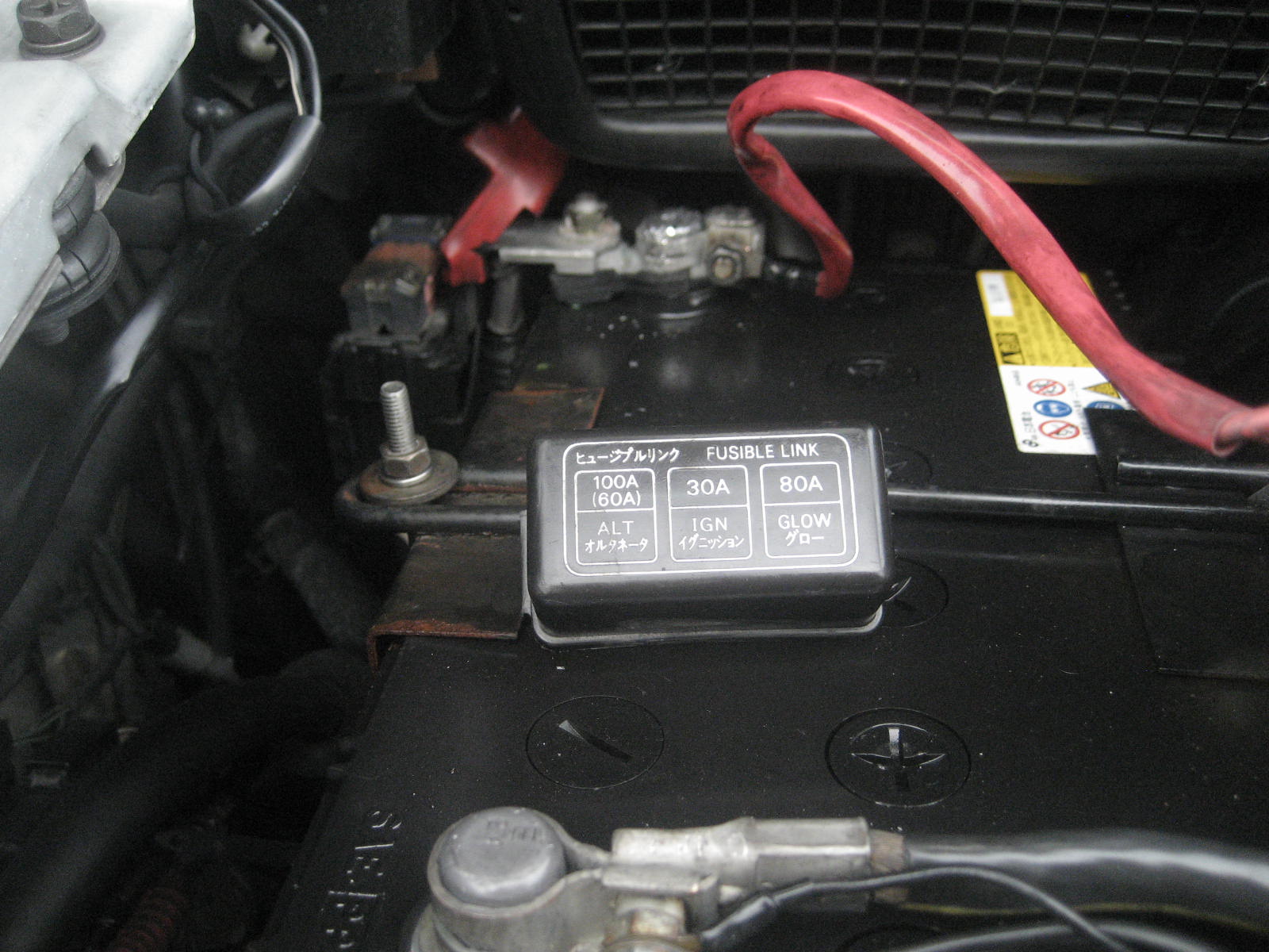

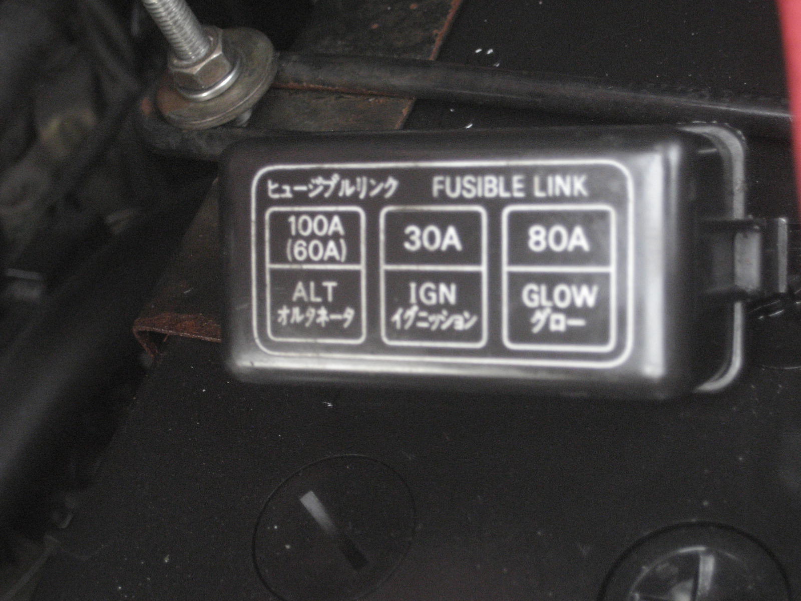

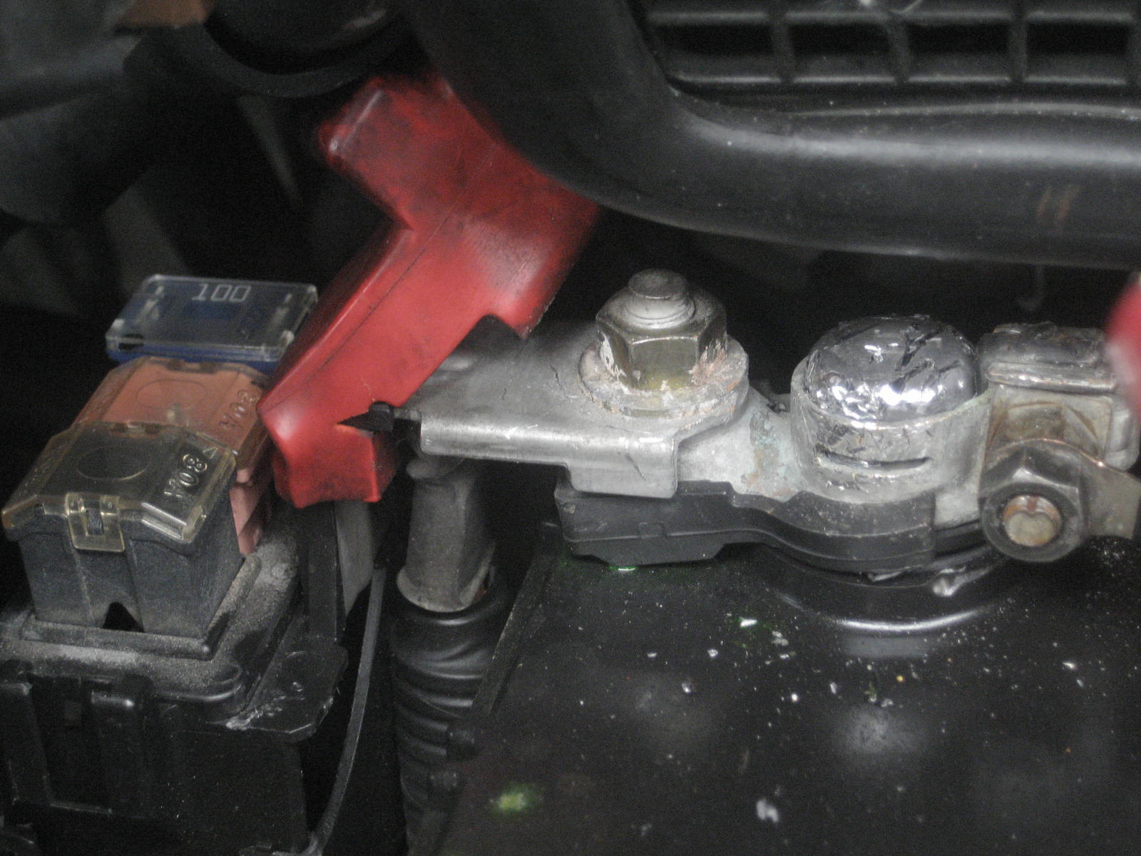

Re: totally noobed out!
Ok here are some pics of the + side of the battery. There are three "fuses" coming off the battery as illustrated...of course I have no idea if they are blown or not, but at least now we are all on the same page
the battery is of course Japanese so who knows how old it is...planning on a replacement when I get home next weekend...

ahhh thanks guys I just got home from a week out sailing around...will pick up a charger tomorrow at crappy tire. Are those fuses on the battery easy to come by? Does it matter which voltage charger I use? ie 12 or up?
