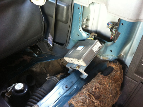

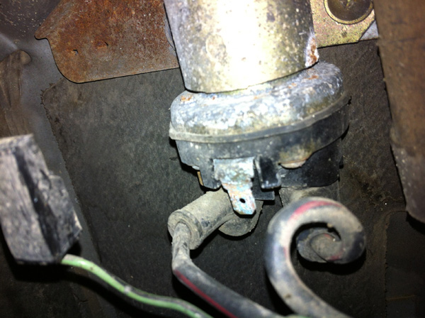

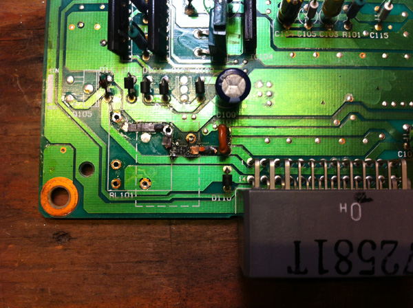

In the morning in Port Moody, Delica wouldn't start. It cranked over fine, but the engine just wouldn't go. I noticed that the wire to the glow plug bus bar was really loose: I could swivel it with my fingers. Tightened it but no change.
I looked on the forum, and it said the ECU has likely failed, and to keep cranking it, to build up heat in the cylinders to start it without glow plugs. Bad advice. Sure, it may build up heat in the cylinders, but also builds up heat in the Glow Plug Relay and the ECU. Quickly reached my troubleshooting limits with minimal tools, called CAA and got it towed home to Kitsilano. $112 to renew membership (including $25 fee for doing it just when I need service) and $50 for over 5km. Let the games begin. I'm trained as an Electronics Technologist, so if it's the ECU, it's a home game.

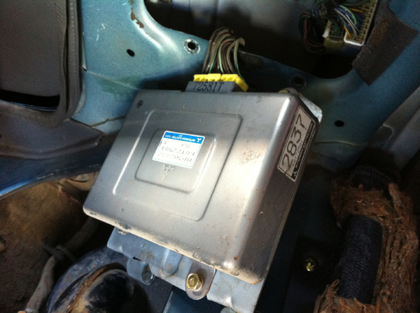

Location of the ECU, behind the right-hand seat, above the hatch with the power steering fluid. The Glow Plug Relay is inside the hatch.

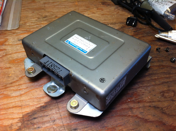

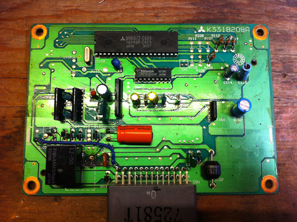

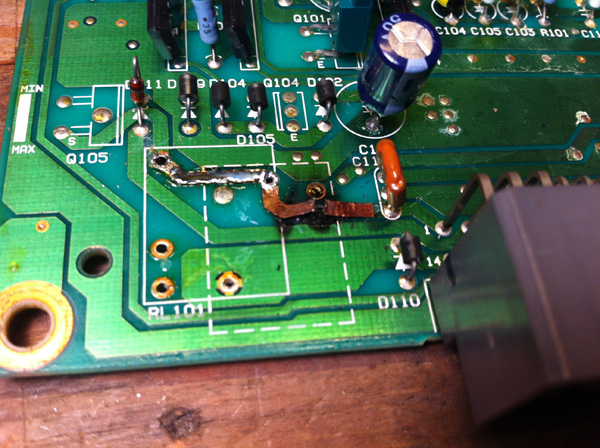

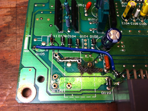

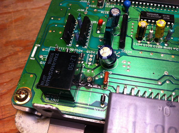

I took out the ECU. It's located in the RHD driver's side B-pillar, behind the seat belt mechanism. Not hard to get out, once you know where it is. Opened it on the bench and a trace to the relay is burned.
Popped the cap off the relay, and it's fine in there. Cleaned the contacts for good measure. Tinned the segment of the trace that had been heated enough to lose its coating, and soldered a 22 gauge wire to bridge the trace that was burned.
Out of space for images...so continued in the next post.

I replaced the largest capacitor, because even though it measured fine, I didn't like that it wasn't glued down. Large capacitors tend to crack their solder joins when they bounce around, and I had a hunch it might do that in a Delica. Put it all back together, reinstalled it, then thought, "there must be something else…"

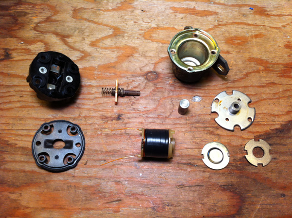

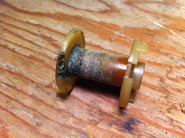

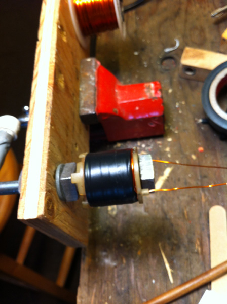

Took out the Glow Plug Relay; it's supposed to measure 20 ohms across the coil, and I measured a short. It's bolted together, so I opened it up and sure enough the coil is fried (and looking most unhappy).
Called CVI and they said they could sell me a rebuilt for $112 (that number again) but generally they put in a manual switch instead, because the ECU is next. But I'd already rebuilt the ECU; if I could fix the Glow Plug Relay I'd have the automated system up and running again.
I looked around for a comparable generic or American relay, went to Lordco and compared it to a Ford Diesel relay. Bigger lugs, so I'd have to change the terminals on the wires to match. They said go to Armature Electric on 5th, which I couldn't find, but on the way noticed a place called Tokyo Auto Service. A smart Mechanic named Vishal called Rocky Mountain Imports on Vancouver Island, and they can bring in new ones from Japan in a week. Probably expensive. Vishal had a generic 12v relay dusty on the shelf, so I bought that for $10 as a backup plan. Again, larger terminal posts.
I still wanted to try rebuilding the solenoid, so Vishal suggested I go to Ashnat Starters and Alternators on Broadway. The guy there wasn't much help, but sent me to Drake's Universal on Francis Ave. They guy there was no help at all, kept saying, "It's not worth it." He had the wire, but it was "too much trouble" to sell it to me. They sell it by the pound, and I need less than that. He suggested Main Electronics, and I gave them a call and they have 1/4 pound spools for $10.

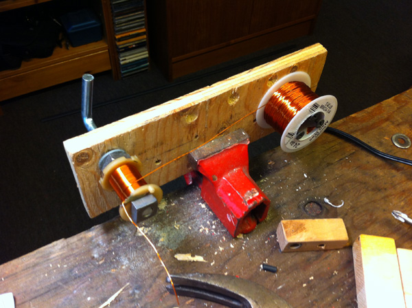

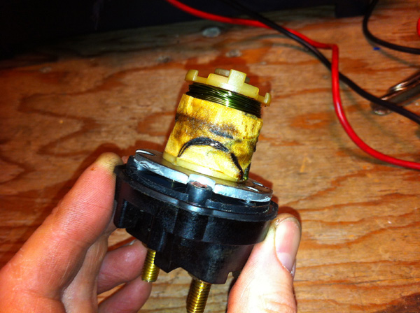

So I rode my bike to Main Electronics just before closing and got a 1/4 pound spool of 24 gauge magnet wire. It is slightly larger diameter (0.057) than the original (0.051) but for some reason I figured bigger was better than smaller. Not sure on that one.
I pulled off the old wire, and sanded the spool smooth. I improvised a winding jig, and wound about 350 turns on it. I counted about 40 per layer, and 8 layers, but really I just filled it up. It's got to be fewer turns than original, because it's thicker wire. I wrapped the coil in electrician's tape.
I cleaned the relay contacts with steel wool, rotated them 180 degrees to provide fresh contact, and swept out the copper powder that had accumulated. I soldered the coil ends into the Glow Plug Relay housing, and reassembled it. I tested it with my Variable Voltage DC Power Supply, and it clicked very weakly, not enough to close the contacts. Discouraged. I took the Chinese relay out of the package and tried the test with that one, and it clicked confidently. I figured I was going to have to go with that, then realized I had tested the Delica relay upside down, with the relay fighting gravity to close. So I turned it over, and it worked! I checked the coil with the ohm meter, and it read about 3 ohms. The Chinese relay measures 20 ohms, like the Delica manual says the original should.
The bits of the Glow Plug Relay, disassembled.
So I decided to install the rewound Glow Plug Relay and give it a go. I did that and the van started! First try. I measured voltage at the glow plugs and got nothing. Which was disturbing. It was getting dark so I slept on it, worrying that the van started without the glow plugs. It was late afternoon, and had been dry for a few days, so not the same conditions as the original no-start.

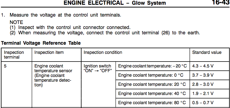

Hi Morganizer, wow, you are about to become every delica owners Newest Bestest friend. Thanks for the detailed photos and the voltage readings for others to troubleshoot.
There is a similar issue. .. I would love to get the correct voltage specs for the coolant sensor thermostat (front left of engine cover) so I can troubleshoot via email with other L300s across canada. This is the 2 pin, screw in sensor, about the size of baby finger. It is needed in cool weather (like under 10 degrees C) to tell the glow plugs to warm up the diesel so it will mist and inject correctly. otherwise one must crank and crank and rough start. They just die every few years of old age, but it is absolutely critical. I have a good one in mine, and I have kept a bad one, so perhaps you can figure out what to test (probably just the top and bottom resistance of the actual sensor. I could drop my good and bad one off for you to play with, or just meet you somewhere and I will show you exactly what it is (not the single pin sensor, only the double is the workhorse, as the single just sends info to your dashboard. You might also have this sensor bad, it won't show up with our lovely afternoon temperatures this week.
I will PM you my home phone, as I would love to have the specs since I expect a rash of people posting about hard cold starts.

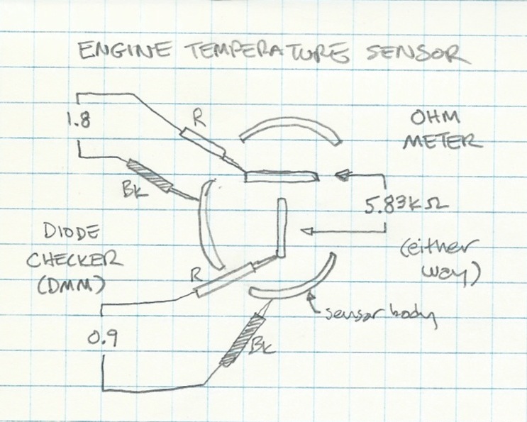

Somewhere on this site (I saw it once but can't seem to find it) there's a post about the T-shaped connector on the temperature sensor, and what resistances you should measure on each. I use my diode checker on my DMM for a lot of power-off troubleshooting, and was surprised that the temperature sensor checked out like a diode, not like a resistor. That is, it seems to not be a resistive element, as one might expect, but is a pair of diodes. This actually makes sense from an electronics perspective, because diodes respond to temperature changes in a linear fashion, and this property means you can design circuits to interpret the changes to gather temperature info.
Anyway, I think the "lost post" I'm referring to provided resistance measurements, which I'm not sure are relevant. In your PM you said, "the voltage of the coolant temperature sensor". In the manual, it describes testing the voltage applied to the sensor, but says it must be measured at the ECU. I'm not sure if this is relevant to the integrity of the temperature sensor either, since the ECU is what's generating those voltages (which is why the manual says to test at the ECU -- because this is a test of the ECU, not the sensor.

I'm going out to the truck to see if I can duplicate the power-off measurements that convinced me my temperature sensor was ok. At the time, I didn't record it because it pointed to my problem elsewhere.
Also worth noting here, the connector for my temp sensor had some kind of goo all over it. Perhaps a previous owner sprayed it with WD-40 and it dried out. I cleaned this with contact cleaner and a pipe cleaner, and I would advise any Delica owner that's under the bonnet checking the oil or whatever to tidy up the temp sensor contact, now that we've seen what havoc any disruption of the ECU system can wreak.
Morganizer
Posts: 191
Location: Vancouver BC
Re: Rebuilding the ECU - Anybody out there?
Post by Morganizer »
Okay, the temperature sensor seems to be diodes, which is why there's probably some confusion about readings. However, since not everybody has a DMM with a diode checker, I took a resistance measurement across the terminals, with a known good sensor, installed in a cold engine, wire unplugged, and the ohm-meter read 5.83k-ohms, either way (red/black). I also measured from each lead to the sensor body, and got nothing (infinite ohms, or open circuit.) This is a quick-and-dirty check, and if you're reading either shorted or open, the sensor's probably pooched.
Now, if you have a DMM with a diode checker setting, the measurements are perhaps more relevant. Measured from each contact to the sensor body, with the black lead on the sensor body. The contacts are arranged in a "T" so from the cross-bar of the T the reading is 1.8, and from the vertical of the T the reading is 0.9. If you reverse the leads, you get infinite ohms, or no continuity, which is what you'd expect from a properly functioning diode.
I would say, if you put one lead on the body and the other on a terminal and measure a short or an open in either direction, the sensor is suspect.
Christine, can you repeat these measurements with your known-good and known-bad sensors to confirm my findings?
