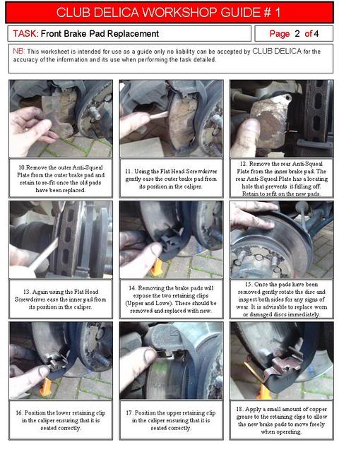

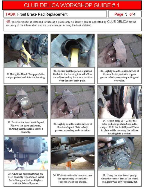

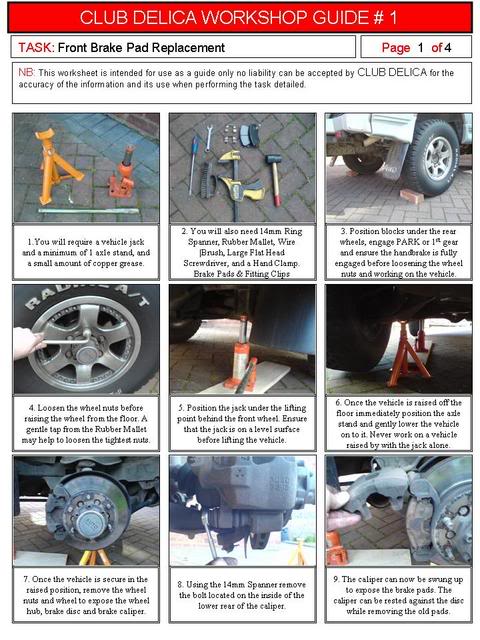

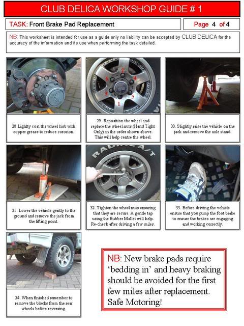

With thanks to another of those nice chaps from the other side of the pond, here's a great replacement break down in pictures.
Thank you Stu of Worcester, UK. :D .
Edit: Step 14 is optional, the old clips are usually re-usable.
