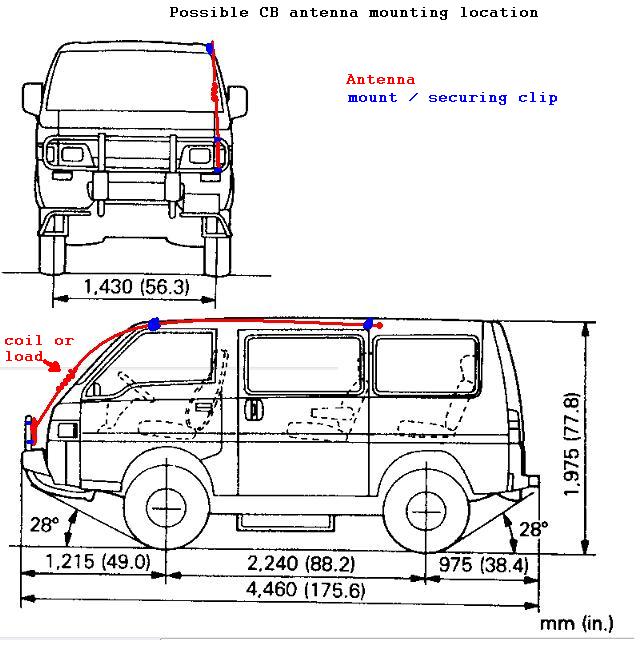

Hello,
I just bought CB radios for myself and a friend and we are looking at how/where to mount antennas. Here are the radios we got http://www.amazon.com/Midland-75-822-Ha ... B00000K2YR
They are "portable" but have very good reviews and come with a vehicle adapter which hooks them into 12V power and an external antenna. We haven't bought the external antennas yet as we are still researching the best one to use and the best place to mount.
I'm thinking of somehow mounting the antenna base to the front brush guard or using a round bar mount on one of the guard bars, and then securing the end of the whip antenna to a rain gutter somewhere towards the back of the vehicle. I would make the rain gutter clip openable so if I wanted really good range I could release the whip and let it go verticle. The rest of the time it could be secured mostly horizontal and not affect height clearance.
Any recommendations on antenna choice, mount type, or mount location?
Thanks in advance, I will report my results!
cb ant.JPG (75.09 KiB) Viewed 7467 times

Christine, there is a huge difference in the frequency that a marine band VHF (157MHz +/-) is tuned for and the frequency that a CB radio (27MHz) is tuned for.
Please be very careful, because speaking of frying things, the antennas are not interchangeable! I suspect you can buy antennas that have dual inputs for both VHF and CB, but they are specialist items.

I hope to mount mine on the bars as my diagram shows, as I already have parkade issues and this should keep it low. Would your mirror bar mount work on something the diameter of a bumper bar?

Ouch. I haven't used CB in years, just happen to have ancient formal training in both radio and microwave and make my living from microwave today.
That said, Wilson is pretty much the gold standard in CB antennas. Shakespeare is worth looking up for Marine applications.
And yes, having shaken off some cobwebs, ISTR that 102" plus a 6" spring is around the magic length for CB (1/2 wave whip), and would be the length of the ancient bumper-mount whips we used to use. Anything less than that is either working due to the magic of loading coils, or is some kind of more modern design as you describe.
Wikipedia has a pretty good article on the basics.

I have done a lot of reading and spoken to a few people about antennas and the compact high tech antennas might work okay, but apparently they don't come close to the range you get from a "big whip" ones, the bigger the better. Apparently the king of all CB antennas is the 102" whip. The majority of these are made by wilson and wilson is definitely the most popular brand. With the length of the delica I think I can run the 102"
My only concern is they all seem to come with a magnet base, I'm not sure if I can just optionally use something like a bar mount.

Loran C is 100KHz, (low frequency) and would normally be used with an active long-wave whip. CB is 27MHz (high frequency) and is normally used with a multiple of 108" for marine applications.
I wouldn't expect a CB to perform particularly well using a Loran C antenna, but if its sitting around it may be worth a try. Use an SWR meter and make sure you have less than 1.5:1, preferably down around 1.15:1.
Typically a 102" whip and a 6" spring is pretty inexpensive, so going after one new may not be too much of a drain. Apart from that, there are tons of choices on ebay.
If I was putting a CB in a Deli and was looking for performance rathe than cool 8-) , I'd probably start by looking at a couple of Firesticks, (probably the 4' ones, but maybe just 2') on a pair of mirror mounts with a co-phased harness. It might be safer to go stainless rather than fibreglass for bush use as the fibreglass is going to be more brittle and break easier, not to mention transfer more load to the mounts...
