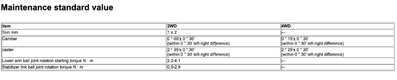

Good day. I'm looking for the specs for a wheel alignment for my '07 D5. I just replaced the outer tie rod ends and control arms. So I'll need an alignment. But none of the (2) shops that I have called have the specs. Can anyone help a brother out?

Is this what you are looking for?
I will have to do the same on my D5 when I change the suspension components and add new camber bolts.
Screen Shot 2022-07-30 at 10.36.36 PM.png (24.29 KiB) Viewed 7103 times

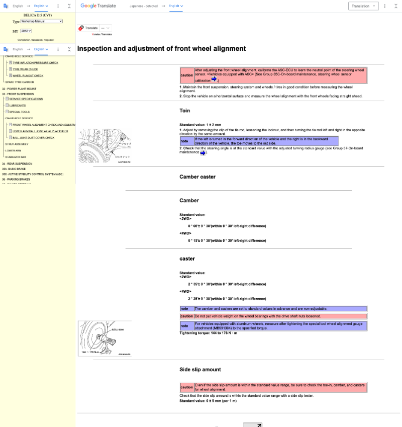

google translated service manual.
Front:
screencapture-mmc-manuals-ru-translate-goog-manuals-delica-d5-online-Service-Manual-2012-index-M1-htm-2022-07-30-22_46_31.png
screencapture-mmc-manuals-ru-translate-goog-manuals-delica-d5-online-Service-Manual-2012-index-M1-htm-2022-07-30-22_46_31.png (168.03 KiB) Viewed 7102 times

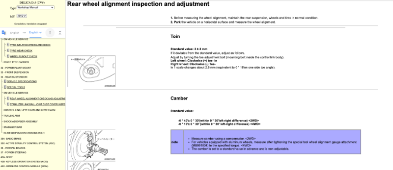

Rear:
Screen Shot 2022-07-30 at 10.48.43 PM.png (89.5 KiB) Viewed 7102 times
Hope this helps!
