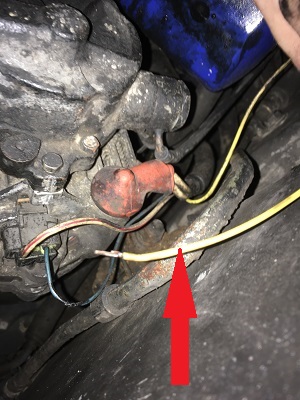

While lying underneath adjusting torsion bars and hooking up new guages, I noticed this yellow wire just dangling.

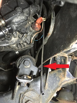

It was inside a protective tube and comes out of the same wire loom as the other wires there.
loose wire 2.jpg (70.72 KiB) Viewed 2988 times
I think that is the alternator behind and I looked all over for a place it might have been connected but to no avail.
Van seems to be running well without it but I'd like to know, ya know?
What is this wire?
Oil pressure warning switch (you don't have the little oil can light before you start the engine, do you?). Should be up high just behind the alternator. Probably covered in oil.

I do not have the oil can light! but I did earlier this week so it a recent detachment...
I seem to have only the battery, the hand brake, and the glow plug/fuel filter lights. I wonder what else is not attached... :-(

All fixed! Thanks again GBNZ!
