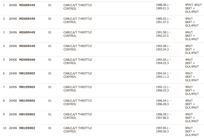

Auto Trans Kickdown/Detent cable failed
Posted: Thu Aug 02, 2018 9:41 am
by sk66
Screen Shot 2018-08-02 at 12.40.42 PM.png (131.78 KiB) Viewed 8029 times
Posted: Thu Aug 02, 2018 1:42 pm
by Growlerbearnz
Those part numbers are for a diesel engined Delica. Andrew has a 4G64 petrol engine. MB919151 is more likely the correct cable for his van.
