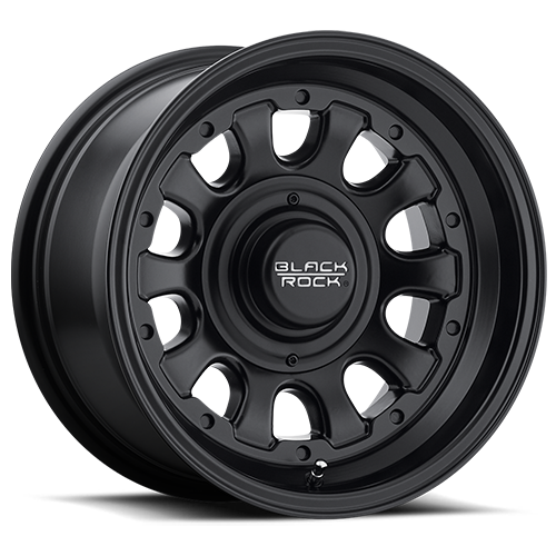

Mmm Black Rock 909-B. A pity they don't come in 16" though, because my next set of tyres will be 235/85R16.

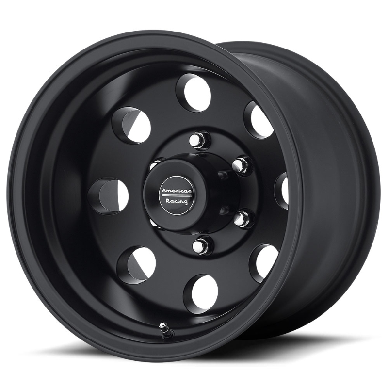

I have these:
American Racing Baja
For tires I have Goodyear Wrangler DuraTrac LT235/85R16

so those American racing rims are 16x8? because I thought 16x8 was too wide...?
