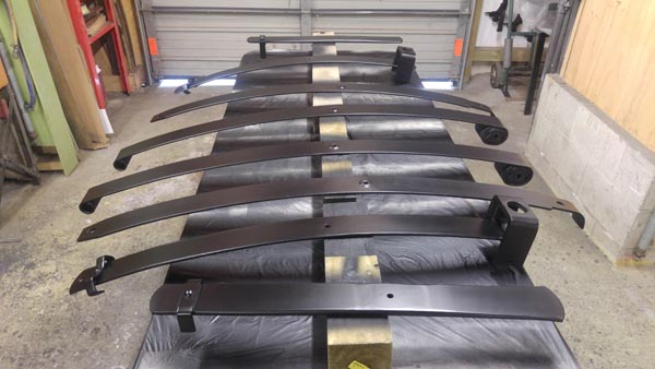

Here's a disassembled spring so you can compare:
20170927_140724 copy.JPG (60.91 KiB) Viewed 5918 times
Maybe just replacing that lower overload leaf with a stock one would fix it? It would allow the re-arched upper leaves to relax, lowering your ride height a bit, and softening your ride.
You've also got an axle wedge in there- below the lowest leaf there's a wedge shaped spacer block (you can see how the top plate with the bump stop doesn't sit flat against the metal case). The wedge re-angles the axle to correct the driveshaft angles after fitting goofy springs.

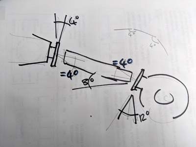

You want the operating angles to be the same- the angle of the flanges relative to the driveshaft. What's your driveshaft angle?
If your driveshaft is at 8° (82° from vertical) your operating angles will be equal: 4° positive at the top, 4° negative on the bottom.
IMG_20180514_094759 copy.JPG (29.32 KiB) Viewed 5850 times
Here's another, slightly longer article on driveline angles, and Bill describes this kind of driveshaft geometry as "broken back" alignment: http://www.pirate4x4.com/tech/billavist ... ndex2.html
