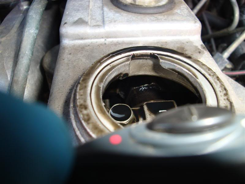

TDC.. DO NOT USE THE PULLEY !!!!
You can remove the rocker cover and use the marks on the cam shaft they have to be right..
OR
You can use the notch on the flats of the camshaft...
You do not want the flats "flat" rather you want the cut out notch as high as pssible... like this
bit hard to see but when you look it makes more sense, keeps the rocker cover on and the job cleaner !!

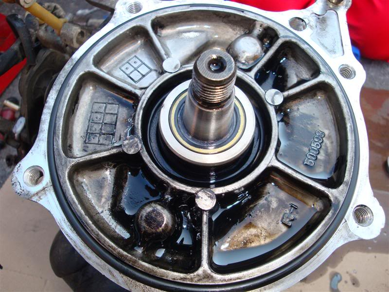

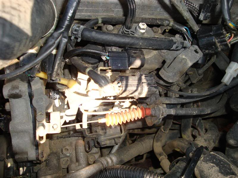

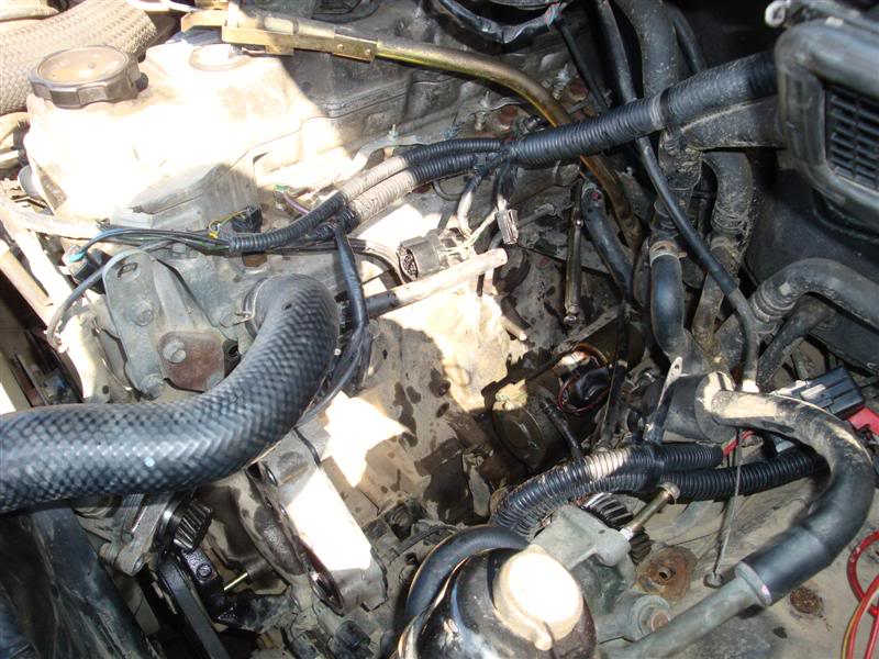

Vacume and oil pump out the way
if you look closley you can see a brass coloured nut down were the A/C belt tensioner is.
you can access the bolt with the A/C tensioner in situ and untouched, the bolt will withdraw but not remove.

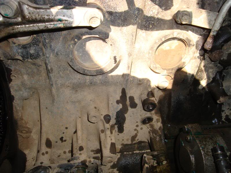

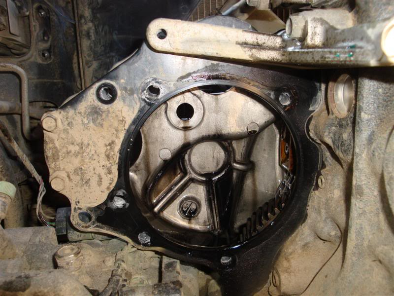

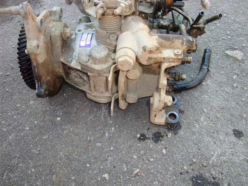

Pump Out... note how little we actualy have to move out the way !!

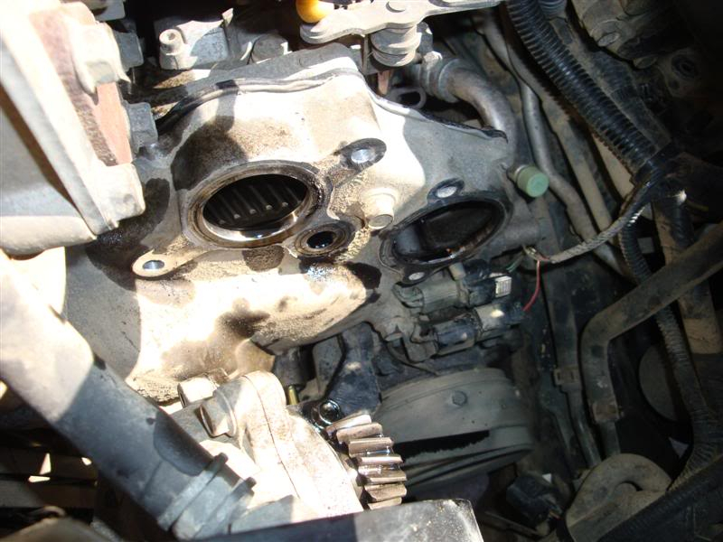

Here is the mounting face were the pump goes...
the fuel pipes come off easy enough just mark them so you know which goes were....
working at the rear of the pump just take them off one at a time starting at the eaiest one.. number 1 !!
Now the hardest part is getting the bolts on the bracket under the pump.. they are 14mm and need a wobble extension bar....
here are the holes on the block
and on the pump the bracket...

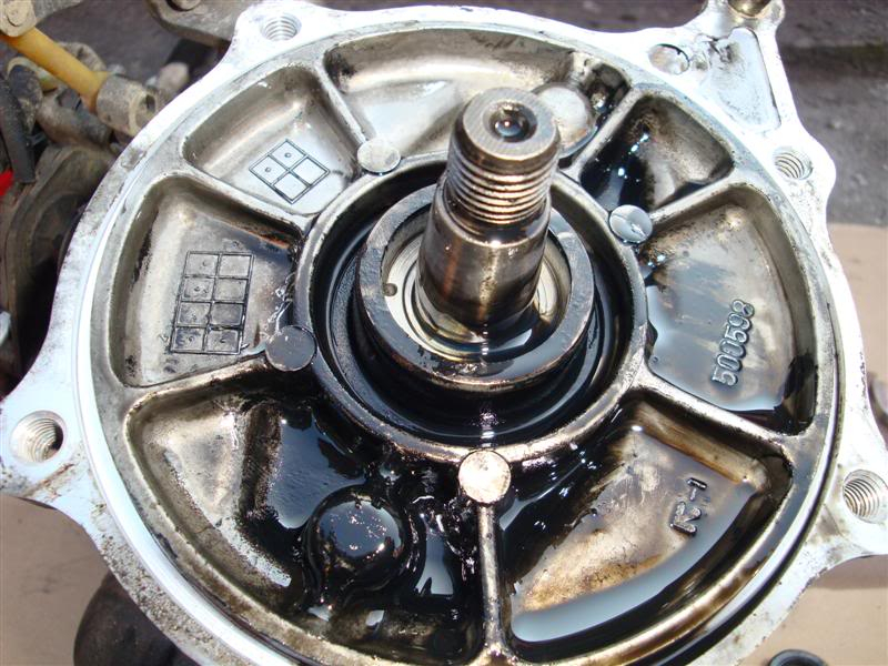

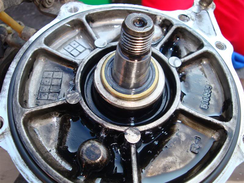

Old seal removed .... be vary carefull as that pump is made from very very soft alloy !!! do not screwdriver between the seal and the case !!
Seal (proper Zexel seal with new rubber sealing O ring from ebay about £10 - £20) aligned

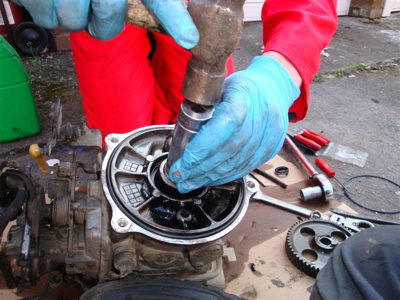

Pushed home with "proper" instalation tool (no its not a 27mm deep set socket that also fits the injectors Wink )
New seal in... fitted...
Dont forget not to lose the woodruff key

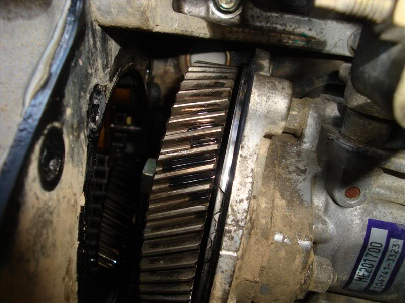

Now time to refit...

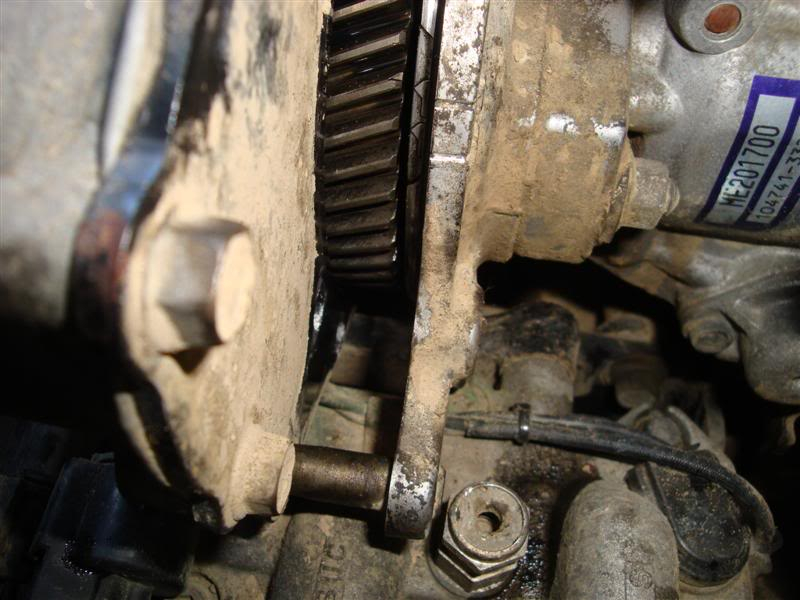

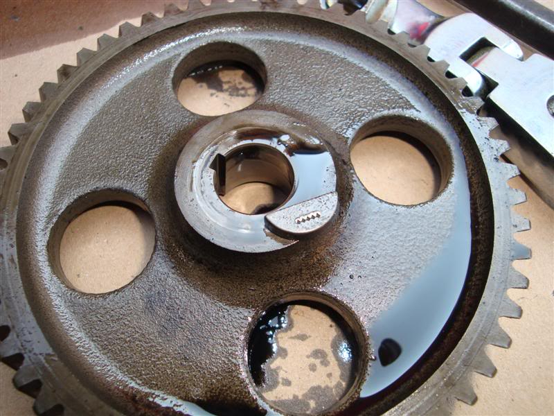

get the pump into place... and have the little notch on the timing gear (yes its hard to spot) lined up roughly with the T on the pump.
(top arrow/notch)
Now align the pump locating dowl with it hole and start to push home...
last minute check the the notched gear tooth is aligned with the T mark (as opposed to the N)
it may not 100% be exact as it has to give a little as the teeth all mesh up
then refit everything...
