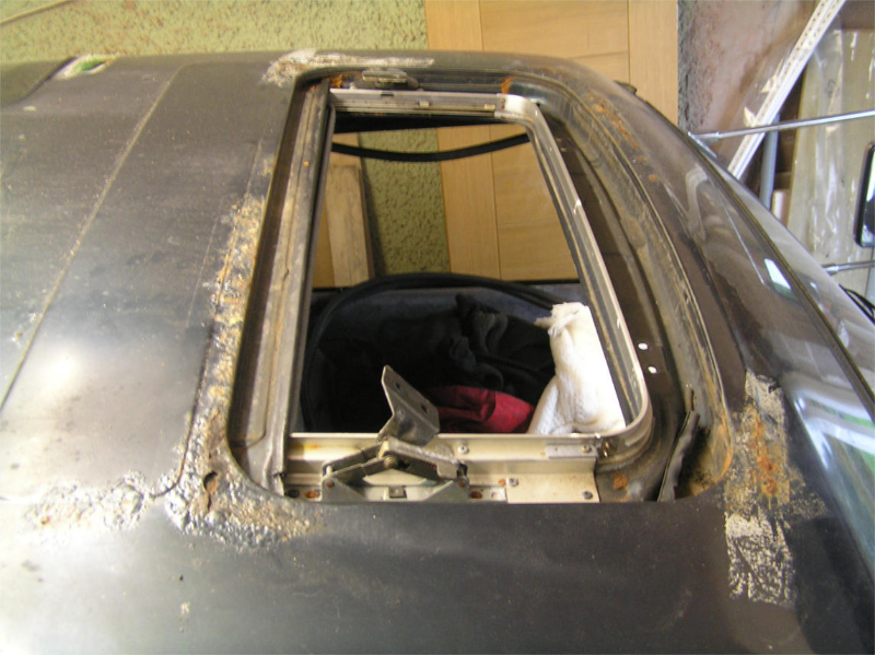

exactly like this image (borrowed from online). luckily without any rust issues. early l300 manual pop up
l300 front (above driver) sunroof- is it flat or curved?
Ah. Definitely curved. It’s subtle but it’s there. I don’t imagine a flat piece of glass would fit very well.
