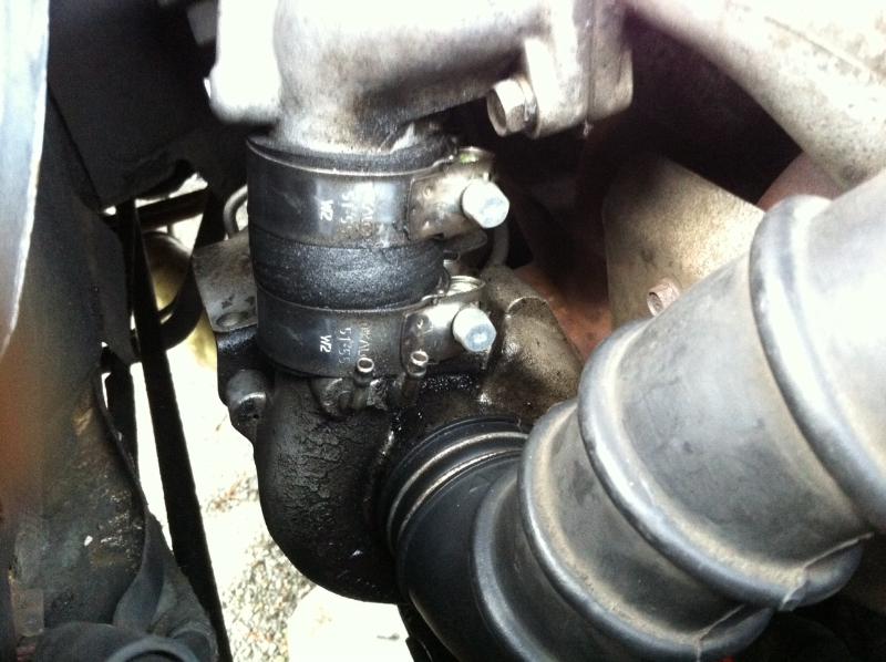

Lots of oil under the engine so of course I have to investigate. Ugh I put in some new heavy duty bolt clamps to rectify oil leaking and look at this mess.
photo 1 (8).JPG (418.47 KiB) Viewed 7352 times
The clamps ended up loosening up a bit and oil is getting through the rubber hose. Either these clamps are a bad idea or it was just the fact that they loosened up a bit ( I could lock tite the bolt maybe....) This blow by is getting out of control I don't even want to know my compression readings!

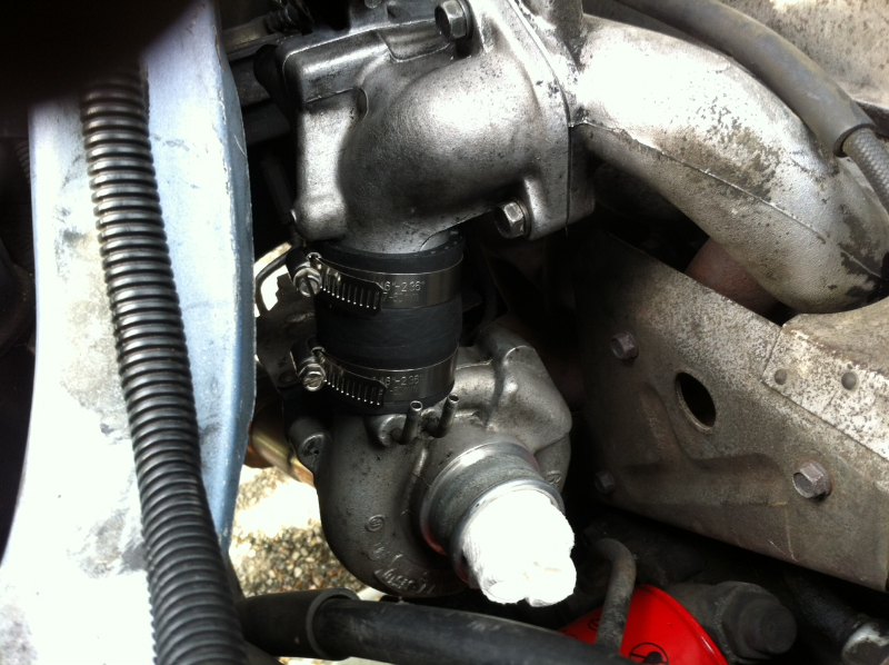

I've installed some regular old gear clamps (like the kind that were originally on the turbo :-( ) Hopefully that eliminates some oil leaking through.
photo 2 (8).JPG (420.09 KiB) Viewed 7352 times
I guess I'll have to install that Provent catch can again!

No expert on this matter by any means, and feel free to correct me, but is there any possibility that it may be leakage within the turbo? I haven't had mine apart (yet) and I don't know what kind of labyrinth seal and bearing arrangement is fitted, but I've seen a scaled-up version (V-16 diesel generator) chucking oil through a turbo like this, completely coating the air manifold with a heavy, greasy, 1/4" buildup.
Just to ease your mind from the compression readings/ blowby.
Does it burn/consume much oil? My fear would be that this excessive oil pouring out of the turbo outlet is an indication of a failed turbo oil seal coating and choking the air inlet side of your engine.

That being said, leakage could possibly occur as a result of higher back-pressure on the oil return line (blow by or blockage), by shaft wear/damage in way of the seals, or a combination of both. Anyhow, just speculation, but a turbo is easier than a full engine overhaul :)
More oily turbo mess
Those T-bar clamps are pretty awesome, they shouldn't come loose. All clamps rely on the springiness of the hose for sealing force, and I suspect your rubber hose has lost some of its spring.
I replaced my hose with some generic silicone hose (in boy-racer blue), and it stopped all the oil leaks pretty much instantly.
Do those T-bar clamps have nyloc nuts on the back? if so, you might want to turn them around so the nylocs are facing forwards, away from the hot bits of the turbo.

Thanks AC, it actually burns no oil at all! I rebuilt the turbo this year and its a pretty straightforward rebuild. Its a pig to take the turbo out though....
Growlerbearnz wrote:Those T-bar clamps are pretty awesome, they shouldn't come loose. All clamps rely on the springiness of the hose for sealing force, and I suspect your rubber hose has lost some of its spring.
Thanks Growler, i've been mulling about replacing that black hose with a silicone one. Guess its finally time to!

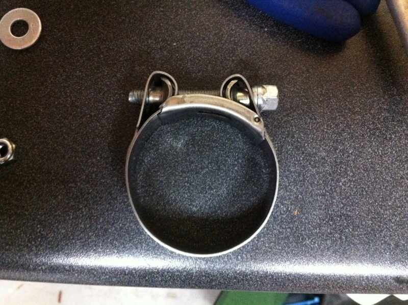

As far as the T clamps goes they do not have nyloc nuts on the back which I think attributed to these clamps slowly coming loose. I've had to tighten them several times this year. But with the design of this T clamp I can screw a nylock nut on the reverse side. Then I'll try to install the Provent left of the fuel filter. I think there might be hope of it fitting in that spot!

Was that hose 2" Inner Diameter by 3" long by chance? I think this measurement is correct just would rather not remove my EGR again to measure....
TRUSTY RUSTY
Mine was 48mm diameter- about 1 7/8", by 75mm long. This one should do: https://www.amazon.com/Ronteix-Straight ... hose&psc=1
