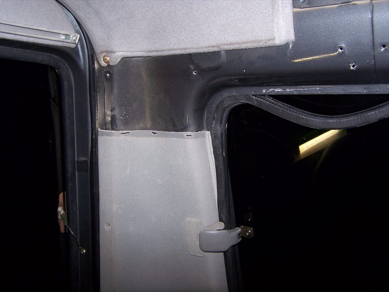

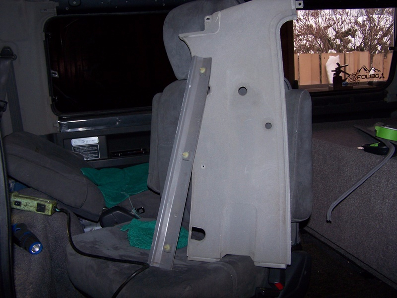

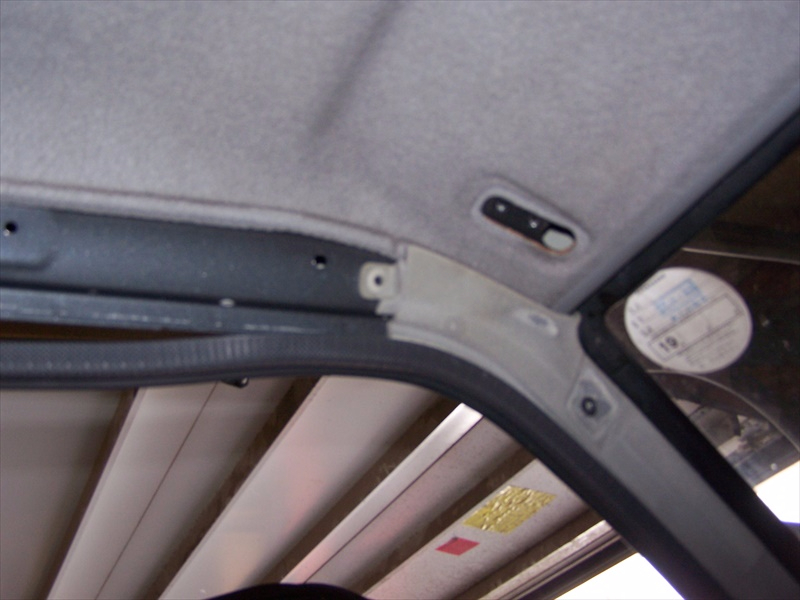

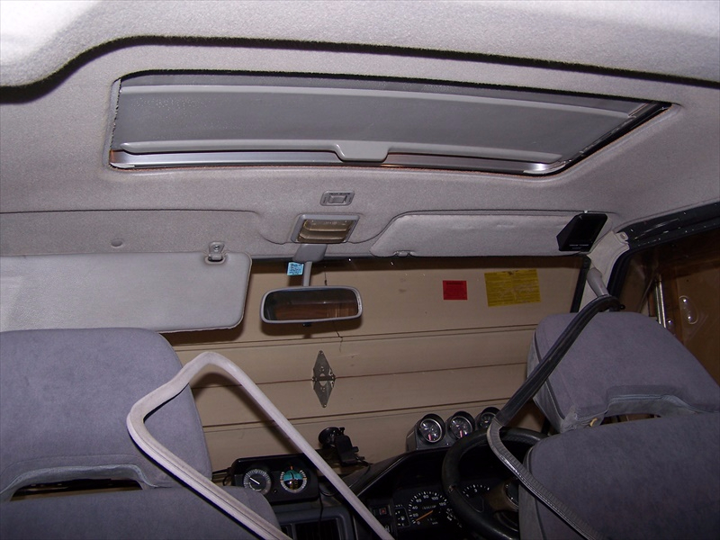

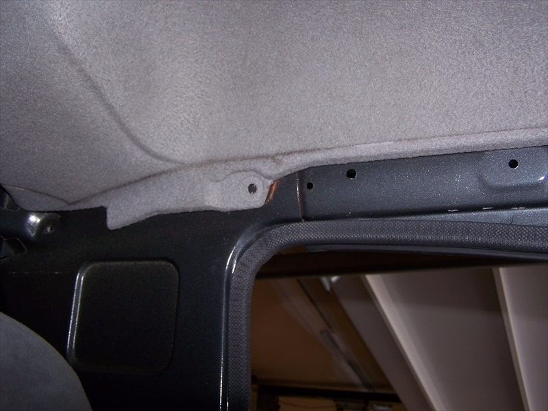

The one blind I needed to fix was @ the passenger door so I began removing the ceiling and window treatment based on the idea that the rest of the roof could remain intact. It didn't take long to figure out this was not going to work as the center light covered bolts I needed to remove as well the cross duct covered some. This meant all but the rear would need to be removed. As it turned out to remove the shade I needed to remove the rear portion as well. If your problem blind is any of the other 3 and you think you can fit the new clip in place without removing the blind much of the roof may be able to stay in place. The removal I'll show will be for the complete roof which will give an idea of all the equipment covered. The one positive of removing the entire roof trim is you will be able to search for rust which is a common problem with CL roofs. I was lucky the only rust I could find was along the rear of the front sunroof and the CL area was dusty but just like new.

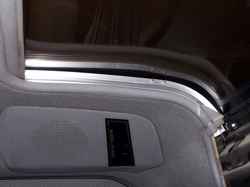

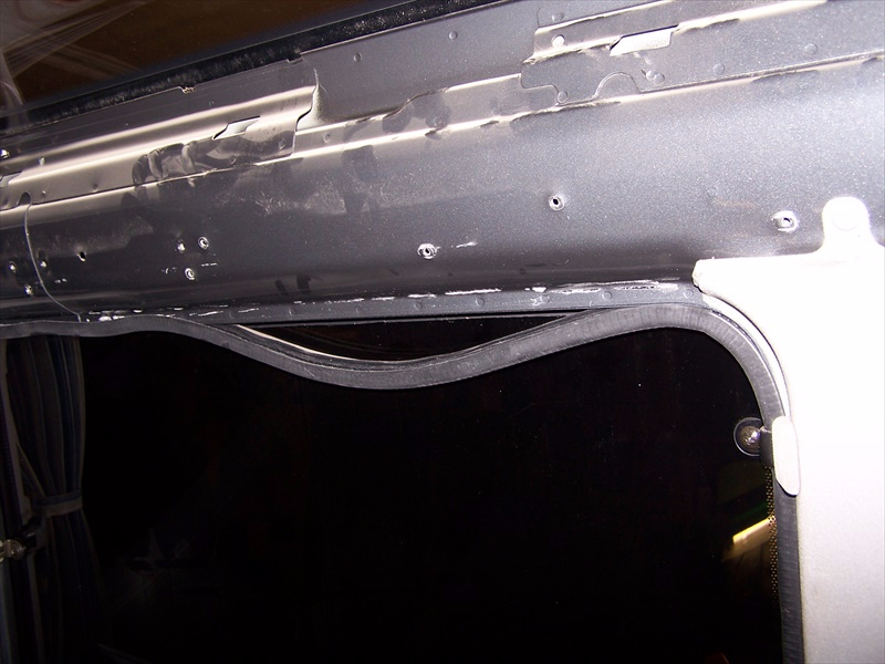

The curtains and side trim are the first to come out. The order is determined by overlaps. Three types of screws are used so you may want to note where they came from. In addition to screws and clips the weatherstripping around the window will need to be removed.
Nxski provides a lot of pictures of the removal in his post. He was looking for rust not blind repair but his pictures are a great compliment to the few I will add.
Curtain trim removal DS
100_8013 1.JPG (381.83 KiB) Viewed 16498 times
Top rail DS front
Top rail DS front
100_8089 2.JPG (337.32 KiB) Viewed 16498 times
Top rail clips PS
Top rail clips PS
100_8003 3.JPG (454.19 KiB) Viewed 16498 times

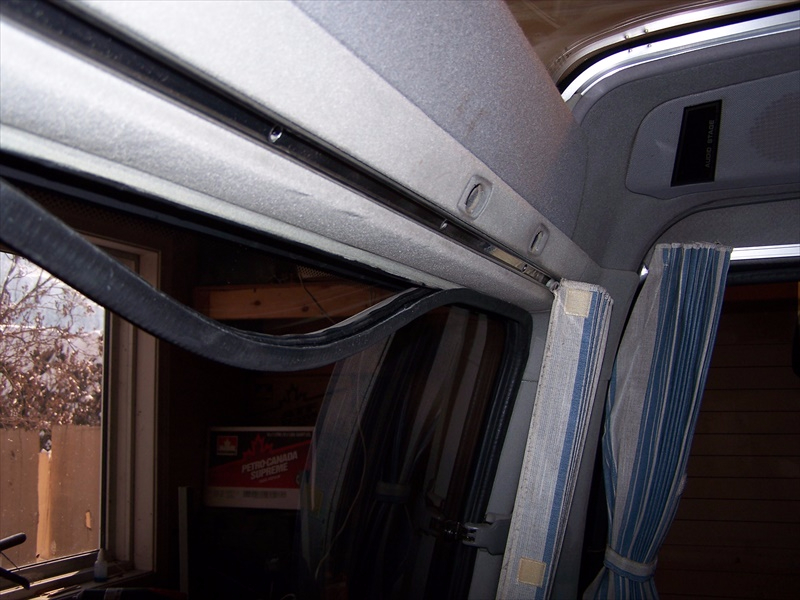

Window trim completely removed
100_8001 4.JPG (337.31 KiB) Viewed 16498 times

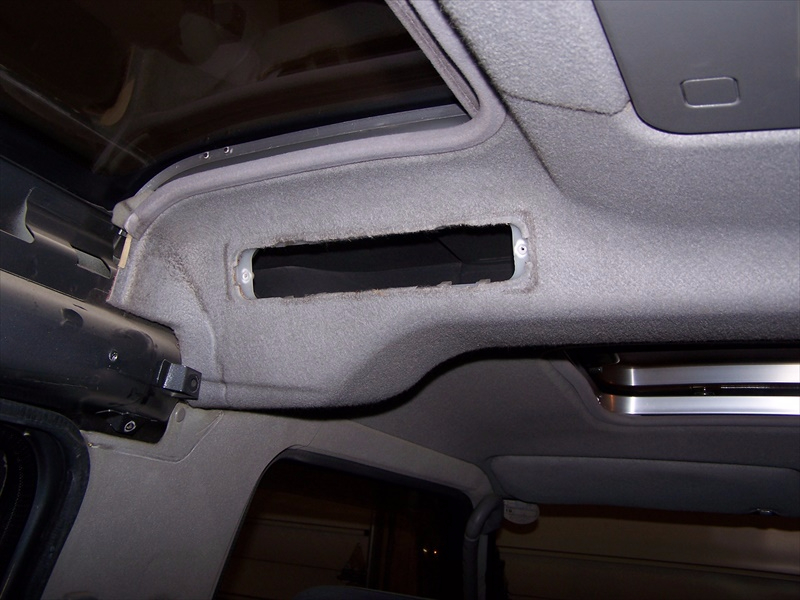

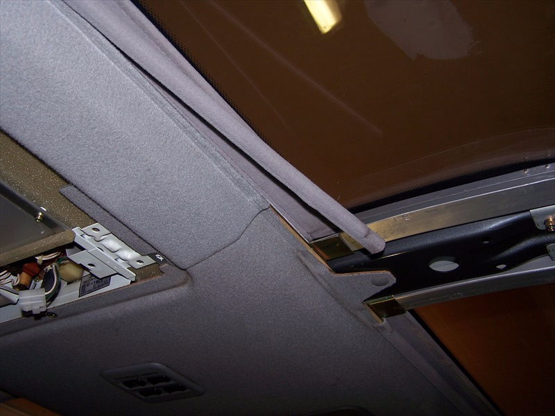

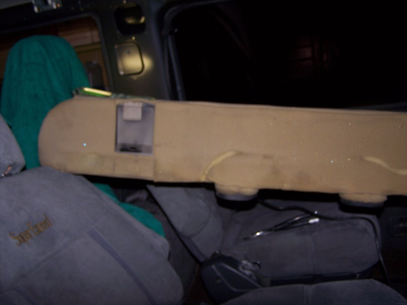

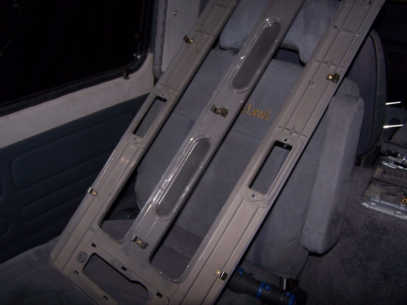

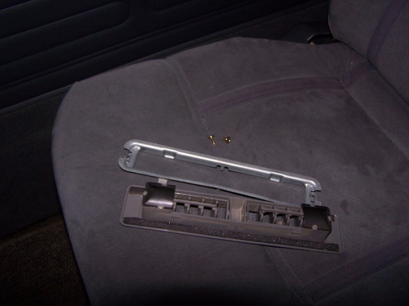

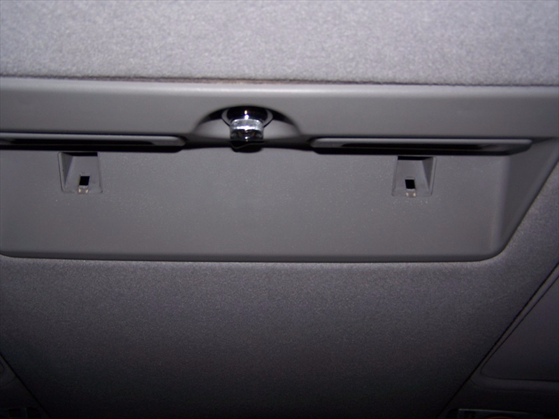

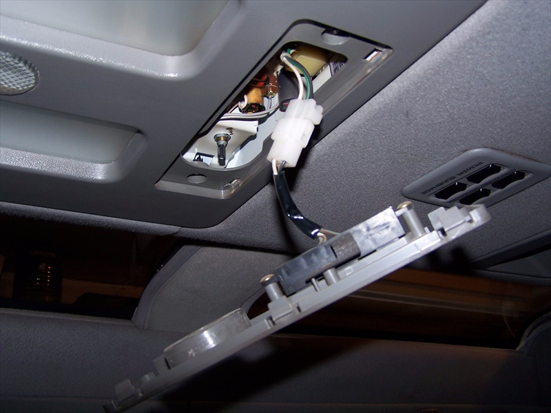

The roof trim requires the removal of the trim around the florescent light first. Once that is complete. I think the front and rear trim are independent. The trim around the light is held in place by 4 plastic button clips and some spring clips that are part of the fixture. The plastic trim around the light is held by screws and a channel trim. The fixture itself can't be removed until one or both of the roof trims are removed unless you want to risk forcing it out. The screws that hold the light are a large Phillips type and strip very easily if you don't use the correct size tip. ( I have pictures )
Trim removal
Trim removal
100_8004 1.JPG (343.2 KiB) Viewed 16497 times
Light control removal
100_8005 2.JPG (338.44 KiB) Viewed 16497 times
Duct trim removed
Duct trim removed
100_8008 3.JPG (337.65 KiB) Viewed 16497 times
Light trim removed
Light trim removed
100_8010 4.JPG (334.72 KiB) Viewed 16497 times
Channel trim removal
100_8011 5.JPG (357.65 KiB) Viewed 16497 times

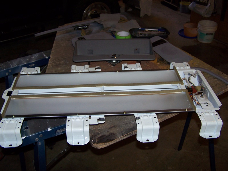

Light fixture removed
100_8046 6.JPG (376.88 KiB) Viewed 16497 times

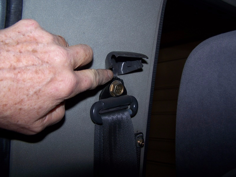

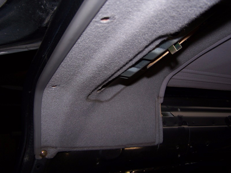

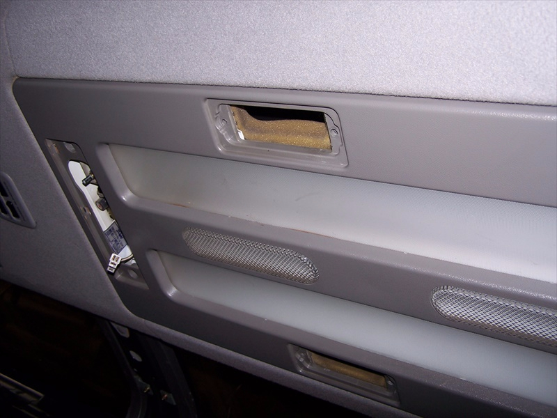

The front trim is a little trim around the doors, the duct work and weatherstripping around the front doors. I removed the trim for the panels behind the front doors which includes the seatbelts. This may not be required but if they are not removed this trim needs to be bent significantly. 25 year old plastic isn't noted for flexibility. The sun visors , dome light and mirror also need to be removed. The front trim pulls away from the front door pillars. Again the order is determined by the way the trim is overlapped.
DS seatbelt trim
DS seatbelt trim
100_8017 5a.jpg (407.07 KiB) Viewed 16468 times
Removal of channel trim and weatherstripping
100_8020 6.JPG (370.23 KiB) Viewed 16468 times

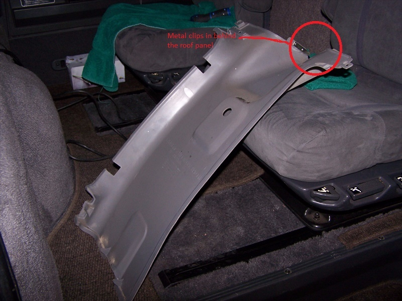

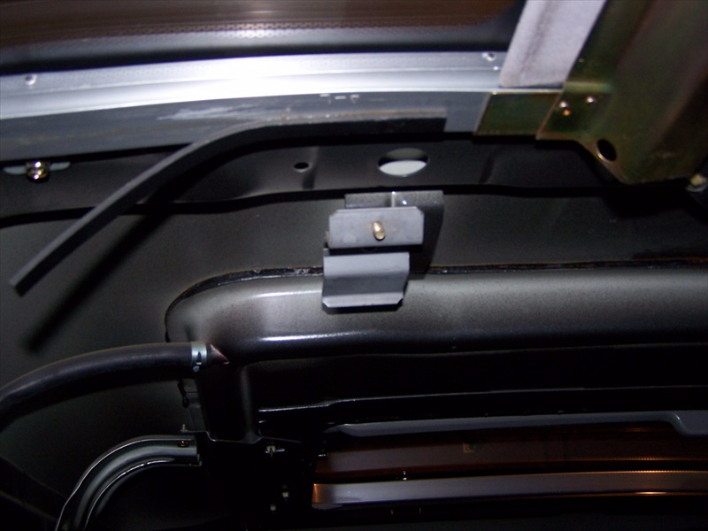

Front area trim part 2:
Trim clip for roof trim PS
100_8024 7.JPG (354.76 KiB) Viewed 16467 times
Roof trim held by door pillar trim
100_8025 8JPG.jpg (313.49 KiB) Viewed 16467 times
Cross duct support clip ( top )
100_8078 9.JPG (234.05 KiB) Viewed 16467 times
Cross duct support bracket ( clip & bolt )
100_8079 10.JPG (307.62 KiB) Viewed 16467 times
Front area with roof panel removed
100_8080 11a.jpg (463.05 KiB) Viewed 16467 times

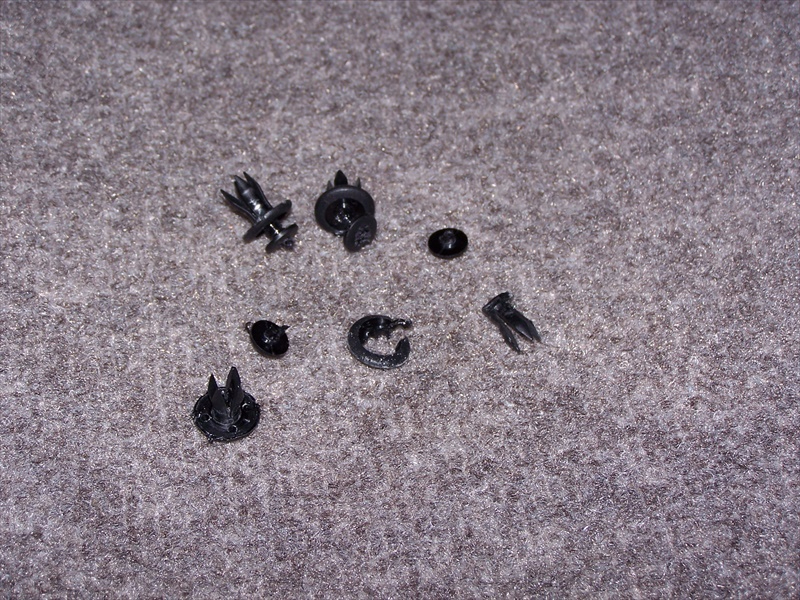

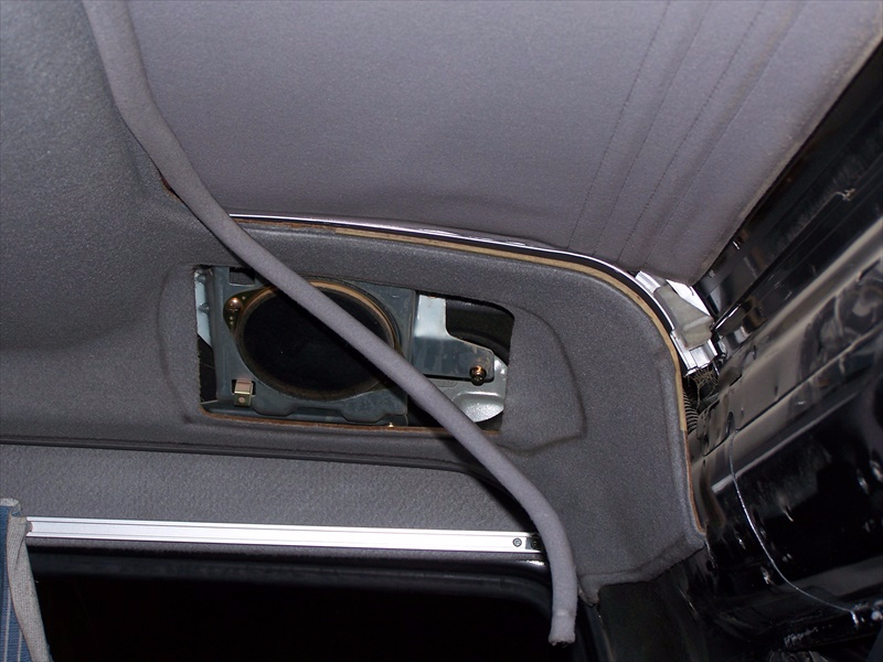

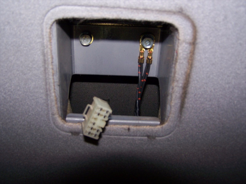

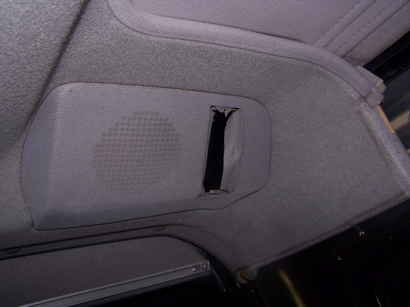

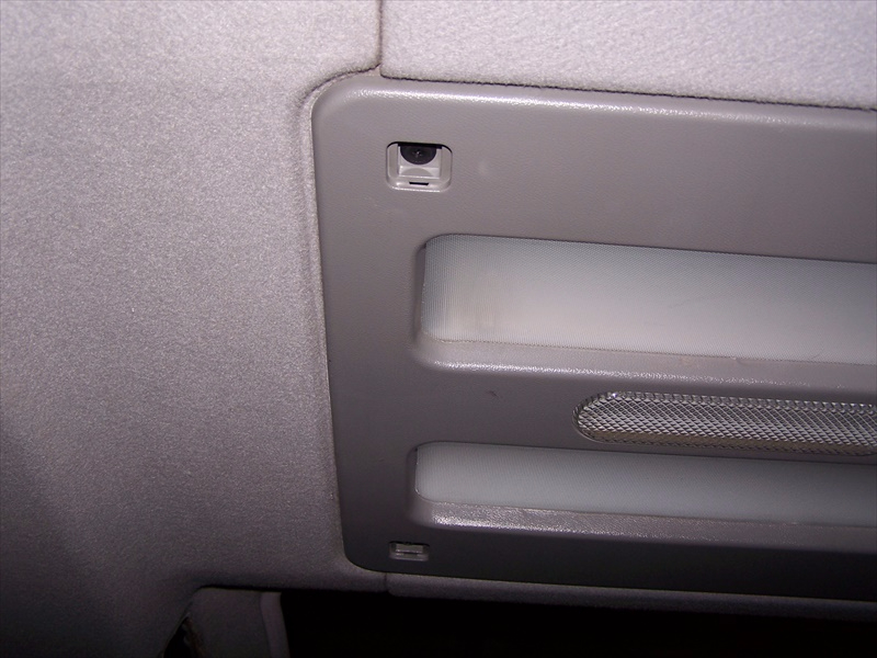

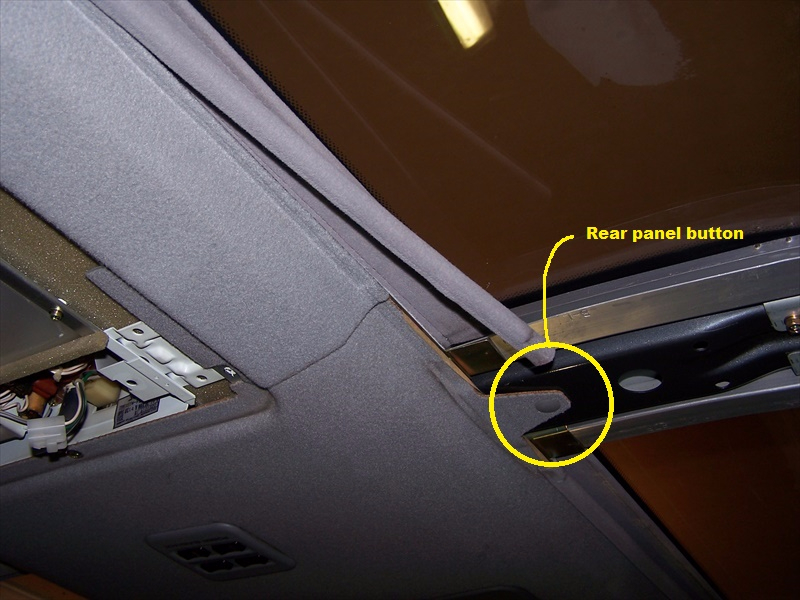

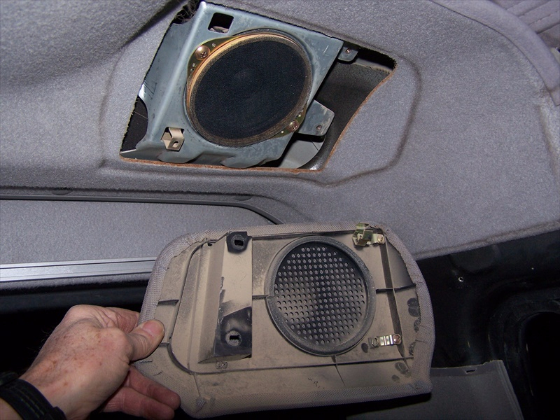

The rear trim is held in place by a few push-in buttons, trim channel around the CL's and a couple screws @ the rear. The small trim pieces that join the roof and side trim also need to be removed.
Rear speaker
Rear speaker
100_7996 1.JPG (383.98 KiB) Viewed 16453 times
Rear speaker access cover removed
100_8040 2.JPG (425.67 KiB) Viewed 16453 times
Rear speaker cover removed
100_8041 3.JPG (465.71 KiB) Viewed 16453 times
Rear light and duct trim
100_8042 4.JPG (258.4 KiB) Viewed 16453 times
CL blind control removed
100_8043 5.JPG (316.24 KiB) Viewed 16453 times

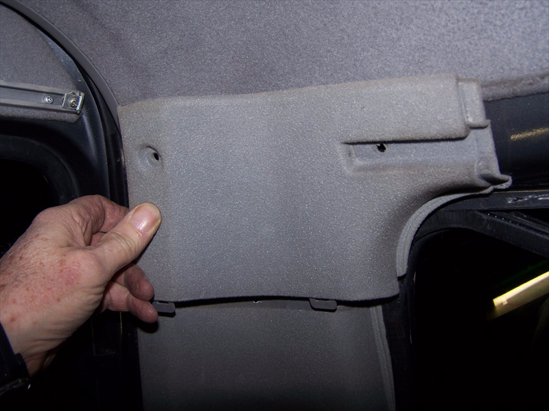

Rear side trim
Rear side trim
100_8038 6.JPG (363.85 KiB) Viewed 16453 times

Rear area ceiling removal continued.

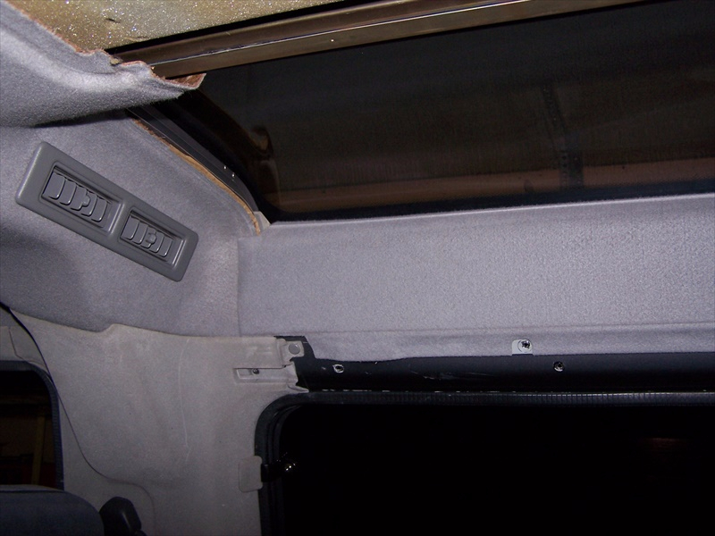

Rear side trim removed
100_8039 7.JPG (293.57 KiB) Viewed 16453 times

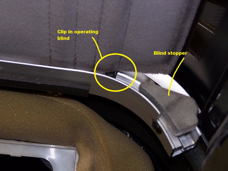

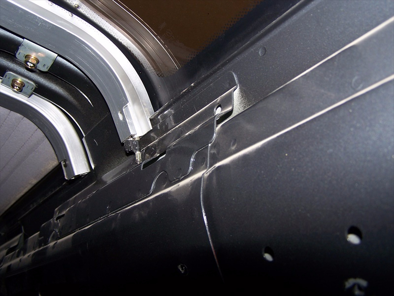

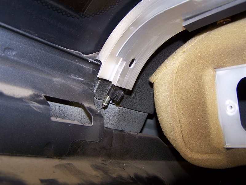

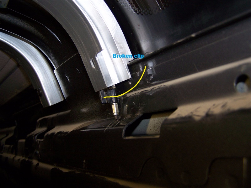

At this stage it can be determined whether the blind has failed due to broken clips or problems with the motors or cables. Usually if the blind has retracted the clip is broken. If it is stuck open or only operates partially then the motor or cable is likely the problem. The clips can be replaced with the metal clips made from pipe strap. If the motors or cables are the problem it usually means a new or used unit. Used units are available @ the typical suppliers. New ones are very expensive if available. Each blind is unique so if you order one make sure it is for the correct location. Luckily mine was a clip problem. The blinds are easily removed once the ceiling trim is out.

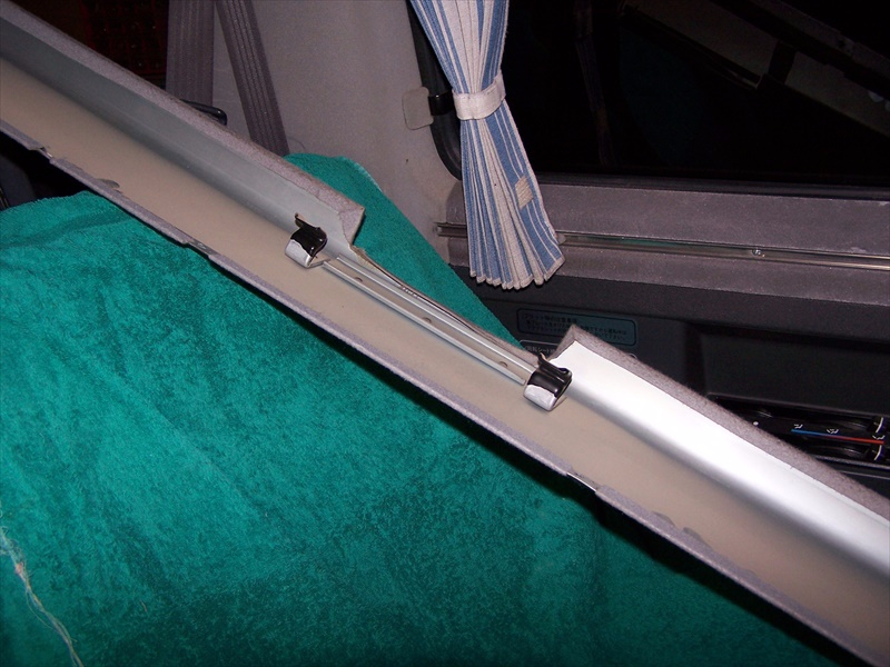

The blinds operate via a small cable that pushes the blind down and a spring return similar to a house blind. The clips appear to break where they go under the U channel. The clip is held in place on the cable between compression collars. A small C snap clip holds the blind clip on the rod in the blind.

Broken clip
Broken clip
100_8034 2.JPG (362.84 KiB) Viewed 16430 times
Broken clip rear
Broken clip rear
100_8036 3a.jpg (339.45 KiB) Viewed 16430 times
