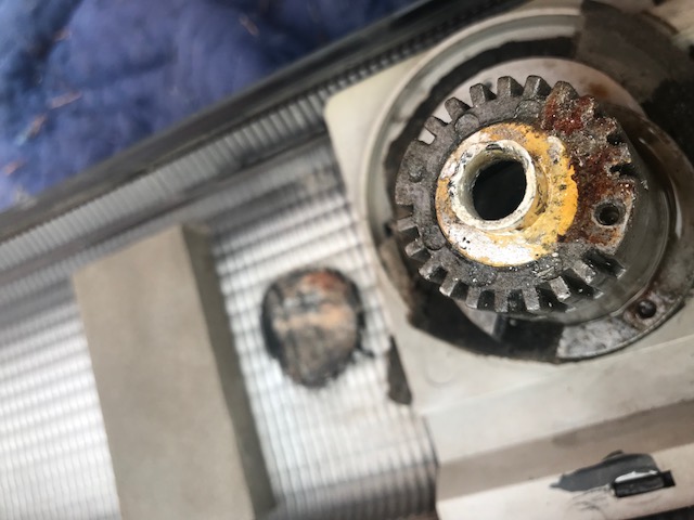

Anyone else have a hard time getting the aluminum piece that the stock light fits inside of, out? This piece here..
Mine looks pretty corroded, I would assume it should just slide out?

Heh mr sa i had the exact same problem with my bulbs the wore totally corrroded i could not get them out at all...in the end i had to drill the suckers out. I wired new led lights in. The lights are working fine but the delica sign isnt lighting up...anyone any ideas??

Dirt and corrosion blocking the fibre optics? You'd need to remove the entire alloy lamp holder from the plastic bit, and then you can clean the ends of the fibres. They're behind a mylar panel to protect them from the heat of the halogen light bulb, but if you've fitted an LED you can remove the mylar.

That piece your talking about is made of plastic so be careful not to break it but it should just slide out. Maybe spray some silicon or wd40 on it. mine was also terribly corroded and I had to drill out the screws. Before I got to finish that project I actually was able to swap tail gates with a friend who was turning his vehicle into insurance so I have the replacement bulbs and the old delica insert from my old tailgate but never finished the project. His vehicle was a chamonix and oddly enough it didn’t have the fiber optics running through the delica logo, and it also looks like it was never tampered with which would leave me to believe that chamonix models didn’t come with the the light up delica logo, can anyone verify that?
