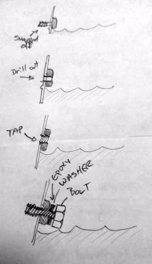

I don't like your chances of finding a sealant that will work for long. On one side you need a stiff sealant that'll take the fluid load while remaining bonded to the steel, on the other side you need a flexible sealant that'll bond to and move with a rubber gasket that's impregnated with diesel.
I think the tank has to come out, and that stud replaced. It's a shitty job because the original stud is welded into place. I would drill the stud right through into the tank (5mm drill bit), tap an M6 thread into it, and screw an M6 bolt through it from the inside. If the underside of the bolt head and internal surface are smooth, you could use a copper washer under the bolt head to seal it, but I'd also use an epoxy sealant on the bolt threads and under the head to lock it in place and help with sealing. Hang on, I'll draw a picture:

I think I will try and switch out the tanks, and if the other tanks is crappy then I will attempt something like your wicked drawing.
