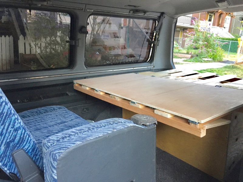

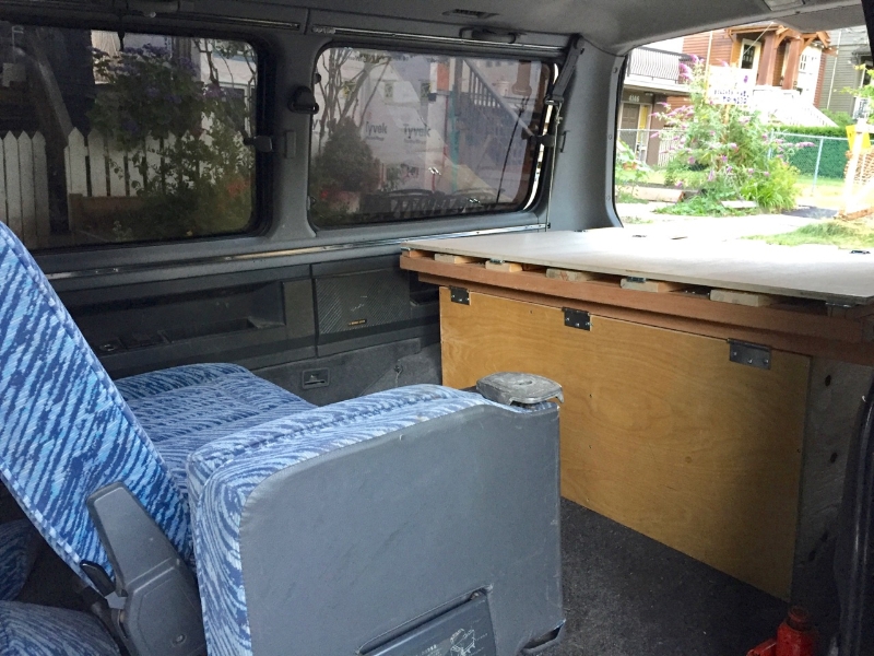

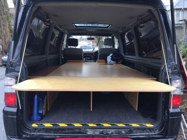

Here are a few photos that should give you the idea. The design is simple - basically just a box made of some beefy 3/4" ply, with a central support. The dimensions, as you can see, basically max out the available space. Height is just shy of 40cm, which provides some space over the wheel wells. The whole thing is held in place with some metal strapping bolted to the wheel wells. Sleeping 3 I can imagine - 4 would be pretty tight.
The clever bit of this design is the table that flips out, providing a table that is outside the van but still under the gate. Not as nice as a side awning, but better than nothing.
If you're not interested having the middle row of seats, then it seems like it would be hard to make any significant improvements over this kind of idea. However, I'm contemplating giving up some of the length of the box and hinging the whole thing so that it folds for the possibility of putting a bench seat back in, but I'm not sure how well that would work.
Let me know if you have other questions, and Gerard, I would be keen to see what you come up with.

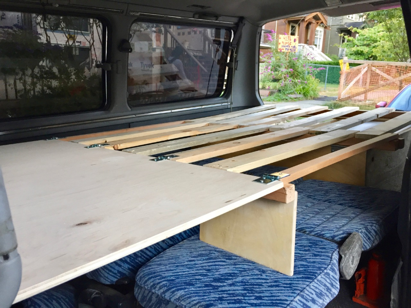

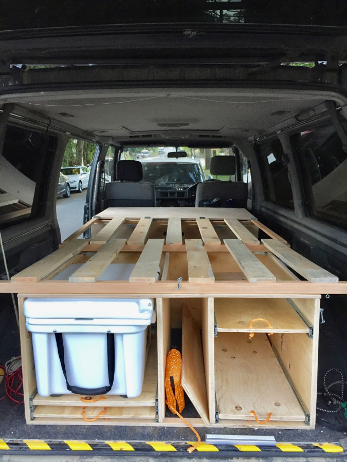

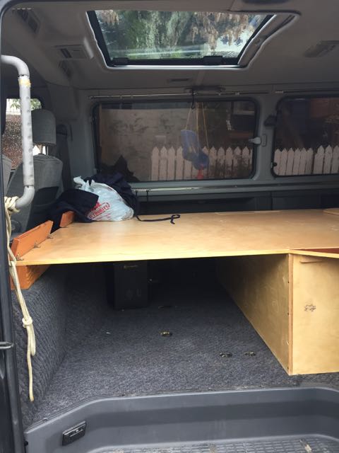

Your plans sounds very similar to what I ended up making. Just put the last couple pieces in the other day.
It's basically a box, about 33" x 40", which fits snugly between the wheel wells, and is about the distance you can get something in and still fold the middle seat down flat. Sliding shelves are on 22" locking rails that are rated to 40kg. The sliding slats are 1"x4"s attached to a 1"x1" pole. The last piece is a 26" x 48" sheet of 1/2" ply, which I thought might be too soft, but actually seems to work just fine (i.e., stands up to a decent amount of weight and rolling around. The expanded bed frame rests on two sets of supports that are hinged and fold up nicely - the first support sits on the seat, the second on the engine block. full bed frame size is 48" wide by 80" long or so.
The system of slats also has the added bonus of supporting itself when I slide it out, so it can be used as a table with the seat facing backward in a pinch.
Mattress to go on the top is a 3" foam mattress, also tri-folding to match the dimensions of the box. Additionally, the entire bed frame part is hinged at the back to allow top entry to the shelves.
ywna, I'll be curious to see what improvements you come up with! this is a rough draft, but it works well enough for my purposes, at least for now. It does make me want a high-roof model, though...
