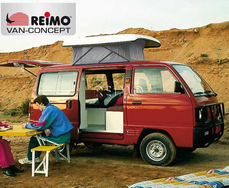

This one I prefer
This one I prefer

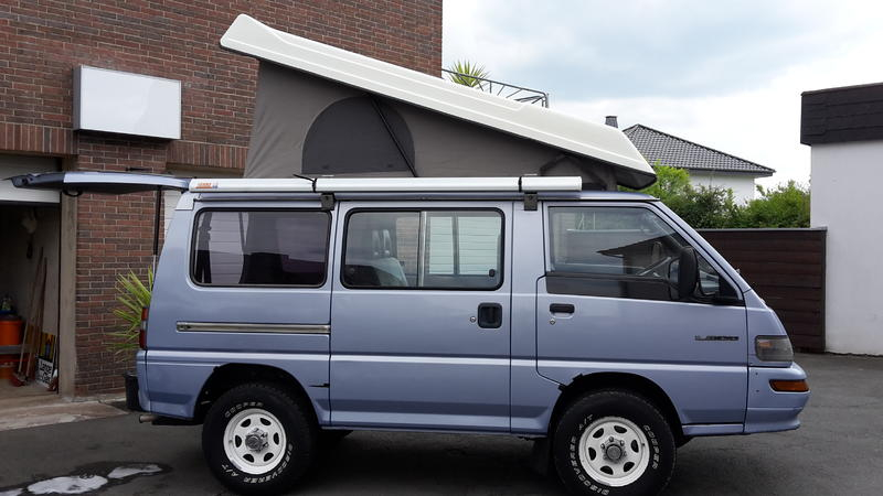

This one THE MECHANIC prefers
