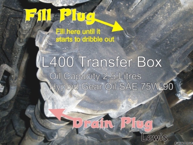

So i took the prop shaft out and a decent amount of oil came out of the transfer case. I'm looking to drain and fill it now as it needs replacing, and I'm having a hard time finding where the fill plug is (I believe I've found the drain plug on the lower portion of the transfer case on the passenger side. Please correct me if I'm wrong)
Is the fill plug just on the opposite side on the top portion and goes in horizontally or is it on the top of the transfer case?
Thanks,
Joe
changing u joints
The fill plug is about halfway up, on the back (facing the rear axle).
Here's a picture of an L400 transfer case (the label font makes me cringe though). The L300 one is very similar:
L300 oil capacity is closer to 2.2 litres.
