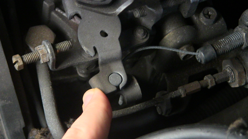

Hey GB, look at this photo
See how the braided metal line bunches instead of retracting into the sleeve? Is this normal? it also looks torn sideways through the rubber boot/cap at the tip of the outer cable. I don't seem to feel it at the pedal, but because of the stripped threads at the adjustment area of the cable I'm wary of it. Am I making it a bigger problem than it is?

The throttle cable is designed to be under tension not compression. Cracking the throttle like that won't really tell you much of anything. If the you can feel stiffness in the throttle, of it seems to hang then you have an issue.. otherwise I wouldn't worry to much about it unless the stripped threads are causing the throttle cable to face the wrong angle.
side note, I see no stripped threads?
Throttle Cable Replacement....anybody done it?
Yup. What Mr. Shoe says. The cable bunches like that because it's connected to the accelerator pedal at the other end, and the pedal isn't moving. It won't retract into the sleeve because it has nowhere to go.
As long as it doesn't do that when you push the pedal, and the pedal doesn't feel like it's binding or stiff, you're fine. :-)

Thanks Tiemyshoe, I was sitting here trying to remember if I had seen it do it when I was running the engine with the engine open. I concluded that I had not seen it bunch, which fits your answer. The part where the threads are worn out is on the other side of that nut in the photo.
Thanks GB, I think i'll give some thread locker a try. It beats buying a new cable. I have 10 weeks to get the Deli ready for a trip down to Florida for my sister in-laws wedding. Breaking down with my wife and kids and all my wife's family watching is not on my list of things to do on this trip. 8-)
