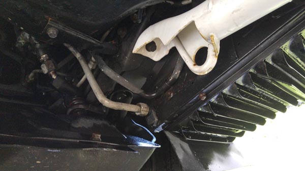

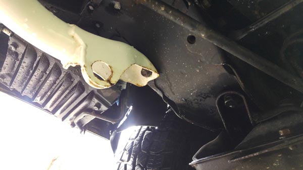

Hi Delica Experts,
Recently i have purchased a delica l300 front Bull bar. But the problem is my delica is 2wd vehicle not the 4wd. But my delica appearance very much similar 4wd and height also close to 4wd l300 delica.
So what i want to know how 4wd vehicle bull bar bracket looks like, that mean how bull fixed to the chassis what kind of bracket is there? what kind of bolt and nuts are used?
So guys Please post some photos of under the vehicle where your bull bar has fixed to the chassis ?
Please Help me ASAP

Have a look at http://dinoevo.de/bull-bar/. If you don't have the bullbars, I imagine the upper brackets (the vaguely triangular bits that go into the front bumper either side of the oil cooler) are the most difficult to figure out.
The lower ends of the bars just go onto the lower chassis rail- there are a few pictures in this thread http://www.delica.ca/forum/viewtopic.php?f=10&t=17357.
The bolts are probably M10x1.25.
I'm not very familiar with the 2WD L300s, but I know the chassis and front suspension is different. It'll be interesting to see just how different the chassis is.

HI friend,
Thanks for sharing the images. I am extremely sorry if you felt that wording as impolite. I was never expected my wording means that kind of thing.
Yes i was little excited that might be the reason.
The shared links images were helped for me have a understand. but little unclear how bull bar lower end has join with the chassis.
will you be able to do me a favor? If you have a delica with bull bar could you please share your own images of how bull bar lower end has fixed to the chassis? that might be a great help.

Here we go- left and right mount points. It's tricky to get a good photo as there are lots of things in the way, and it's raining so I wasn't going to roll around on the ground:
On each side it's just a single M10x1.25 bolt that goes into a captive nut in the chassis rail.

2wd L300's have straight chassis rails,while 4x4 models have a 45 degree upturn then horizontal towards the front.

Thank you very much for the images and your ideas. Yes there is a different of chassis. but that might not be a big problem i will do something for that.
Other thing is only that bolt is enough for fix this bull bar? i mean strength is enough? or is there any other place to put some bolts? (either side of oil cooler)???
