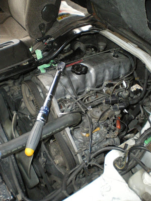

- a torque wrench in inch pounds (not 100% necessary but always good to use/have)

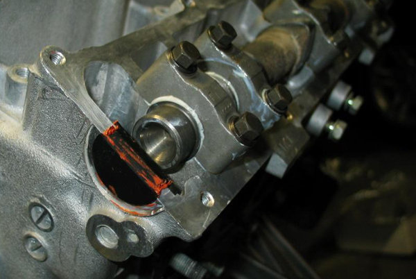

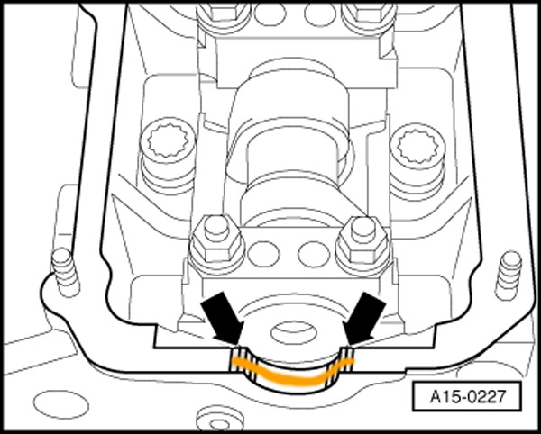

The halfmoon is a hard plastic or aluminum part, not a gasket. Put a bead of high heat silicone in the groove and press the halfmoon in there so it creates a good seal. The trick is to apply enough goop to seal the halfmoon, but not too much, or the excess silicone may fall into head and cause issues. Make sure that you press the halfmoon deep enough so that the mating surface for the valve cover gasket is smooth and flush. I would not use silicone between the valve cover and the valve cover gasket as it creates a big mess to clean up later. The hardest part about this job is getting back there under the engine cover, and being able to see what you're doing. I use a small mirror.
The pictures are not from a Delica, but you get the idea.

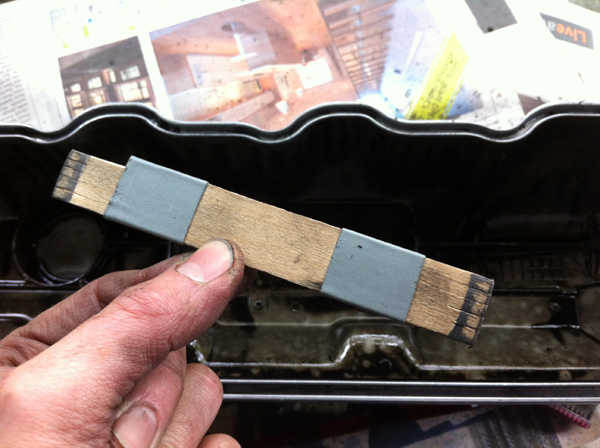

So this took me 5 hours, mostly because, "Double check the top of the head that it's clean and there are not pieces for dried up gasket stuck to it." I'm not sure if it was old gasket (the one I took out was intact, so maybe residue from a previous gasket) or Permatex Black, but I had to scrub little bits of it for a couple of hours to get it clean to my satisfaction (those who know me, feel free to chuckle at this point.)
My tool of choice for this cleanup, better than brass brushes, Scotchbrite, or jamming rags in the groove was this:
It's a tongue depressor, cut at 90 degrees to get rid of the rounded end, then split into 5 pieces, and tape wrapped around to keep it from splitting any further. I scrubbed back and forth in the groove, like a broom, and because of the splits it would curve around corners, especially useful on the glow plugs side where nothing's a straight line. It rubbed the debris into little, snake-like goobers, that I whisked out with a toothbrush.

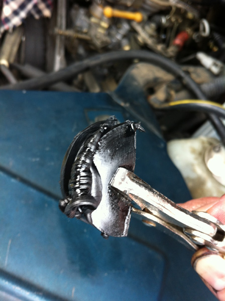

I read somewhere, to get the half moon seal out you just reach back there and pop it out with your fingers. I had to get small vice grips on it, and you can see there was quite a bit of goop holding it in place. See the importance of applying only a small bead of Permatex Black when reinstalling.

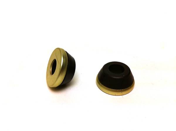

Can someone explain the half moon phenomenon? I mean, why not just make the surface flat all the way around? Is it because they need the half moon cut-out to get the cam shaft in? I'm sure it's necessary, just inquiring minds want to know.
And the other mystery, when I ordered my gasket, it came with two rubber seals, which I installed around the bolts that go through the head cover...and it also came with two more, similar seals (these ones with metal cups on the back) which I didn't use because they're for larger bolts than the ones in my engine. Anybody know about this? Are there Deli engines with valve cover bolts larger than the ones with 12mm heads on my engine?

Oh, and I don't have a torque wrench, so I just imagined I did, and 4-5lbs would be way down at the light end. Then I couldn't get the timing belt cover to seat unless I tightened down the front some more. So I torqued it just until it fit, then pulled on the back bolt about the same. Probably around 7-10lbs, I reckon. Or maybe when the timing belt cover just fits over the valve cover, that's 4lbs spot-on, and so you don't really need a torque wrench. Food for thought.
