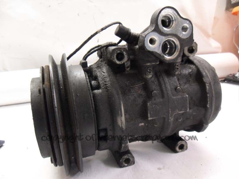

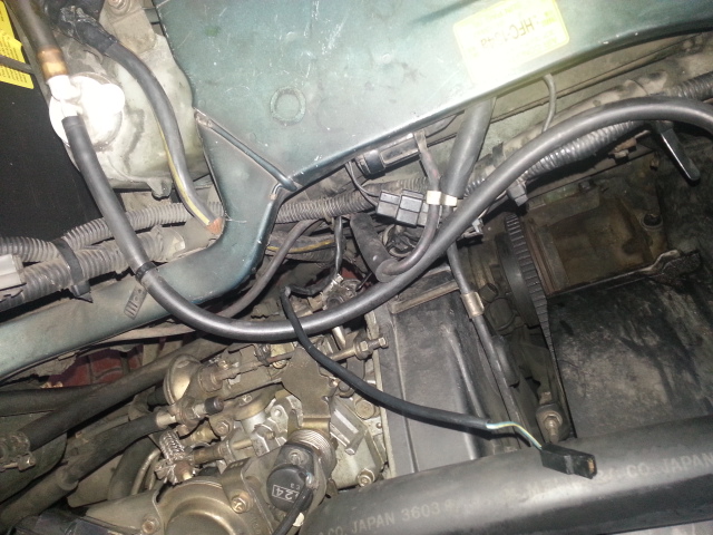

I can't seem to find where to connect the 12V wire that should go to a/c compressor. Mine somehow came off - not connected any more, compressor won't engage.
Tested - the wire shows 12V when a/c switch is pressed.
Attached 2 pictures ... mine looks the same. Strange the wires attached to the compressor only connect to (-) .
Where do I connect the (+) 12 V wire ? Puzzled....

Not sure why I can't attach pics ... anyway... mine looks like this one for sale - it has 5 pics..
http://www.ebay.co.uk/itm/251997081762? ... rmvSB=true
Admin: added a locally-hosted copy of referenced picture.
I don't see another socket for the (+) wire.
The one attached is (-) as I figured out ...

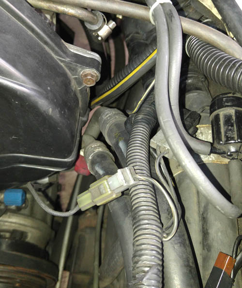

is this the one (thermo switch) where I need to connect the wire to ?
After looking at the PDF & a few other pictures I had no doubts that's the thermo switch.
Attached my wire to it & compressor is back in business. Suspect it was disconnected last November when all the belts +water pump were replaced & never connected back until now.
Thanks everyone who reponded !!!
PS. Still a bit puzzled how is it possible to connect +12v to engine body to engage compressor :-), but my electrical skills are at the high school level.

Yes, you are correct. The compressor gets (+) through the black/white stripe wire (long wire from the compressor), then to earth through the short wire on the compressor.
The thermo switch in your photos looks like the correct one to connect the blue/yellow wire to. If you can test the thermo switch, check that it is connected to earth, but you won't harm anything by just connecting the blue/yellow wire and seeing what happens.
I can't send you a photo of my own blue/yellow wire because I don't have a thermo switch any more, sorry :-)

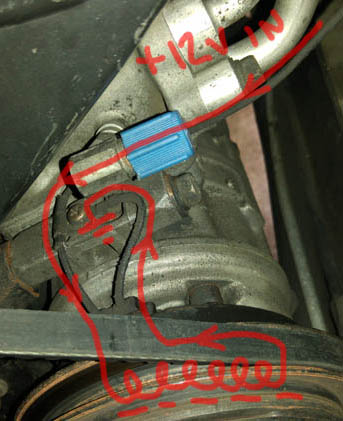

Re: L300 a/c - compressor wires
Great!
The +12v wire to the compressor doesn't go straight to earth/engine body, it first goes through a coil behind the pulley. If you look at the compressor with the engine running but AC off you'll see part of the pulley spins, but the steel disc at the front stays still. When you turn on the AC the coil creates a magnetic field which attracts the disc to the pulley, and starts it spinning, running the compressor.
