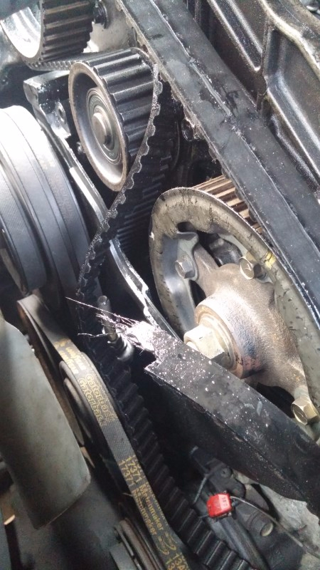

Replaced 'near' the timing belt for effect, but it was just sitting in there, busted. :)

Do you think the timing belt is hooped now that it's probably been slinging around with some oil for a little while? Or could I give it a nice soapy clean and dry everything with compressed air? They seem pretty hardy.

DEFINITELY replace the timing belt. Oil degrades the rubber, and washing it wont repair any damage. The cost of a new belt and tensioner pully is far less than the cost of a new head, and since youre in there already...

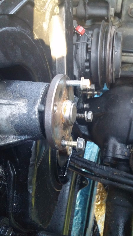

Pulled out the rad and noticed something funny about the fan bolts.
Yep! Each bolt hole housed a completely unique item. 3 TOTALLY DIFFERENT BOLTS + one Sheared Bolt...
That is a genuine *FacePalm... Now I'm proper worried.

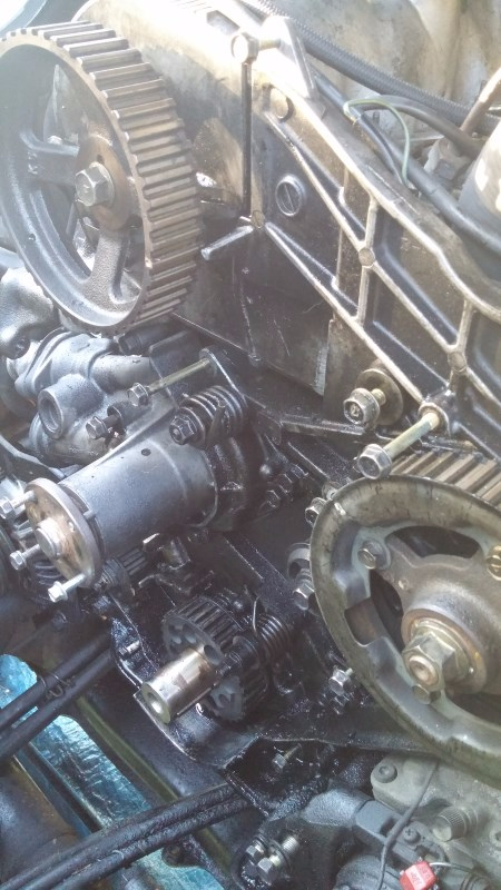

A little more movement today. Here's the successful layout in order to move the Crank Pulley bolt which was pretty darn tight! Seal was definitely spewing as there was still a little pool sitting near the bottom of the seal. I'm really looking forward until I can start putting this all back together.
Flat pry braced against some webbing with a breaker on the other side. Persuaded the bolt to move.
This was by far the most 'fiddly' bit as you all know and as I have just learned. There was plenty of oil around so I decided to pull the alt.
This thing needs a good cleaning, but overall looks in pretty good shape, if not relatively recent.

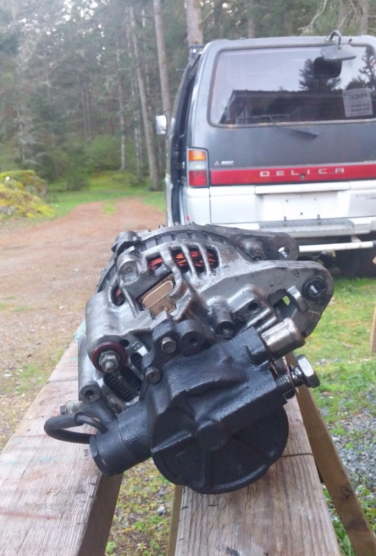

I sure wondered what that thing was on the back. From the hundreds of posts I've read it seems to be a vacuum pump? And why is there a 1" friggin oil tube leading into the oil pan? Geez... I've still not read anything that great that describes the function of this thing and all of its ins and outs.
Just need to pull the balance shaft pulleys, and waterpump.
The vacuum oil pumpy thing. :)
Couldn't really pick out where the plugs are to 'lock' the balance shafts. I'll take a closer look this weekend when I start re-assembly. Oh, I read somewhere that we can re-use these copper washers around the banjo but it would be a good idea to 'anneal' them? hehe... Maybe just new.

Re: 1991 Battle Star Landram Projekt
On a gas engine the brake booster is driven by engine vacuum, but diesels don't make engine vacuum so they have a separate vacuum pump. The location varies on different engines- some are separate like a power steering pump, some are electric, Mitsubishi tend to put it on the back of the alternator. It has an oil feed to keep it lubricated and help sealing, and the big pipe is just to let the oil drain back into the sump. They're fairly reliable, but sometimes the seal on the input shaft fails and your alternator starts dripping oil.
Copper sealing rings are definitely reusable- they harden with age and use, but annealing them softens them again. Just heat them until they're glowing dark red, leave them to cool slowly (away from moving air etc), then gently clean off the oxidation with a wire brush.
Balance shaft locking points are easy- anywhere through the steel cover on the injector pump side, and the locking plug on the other side.

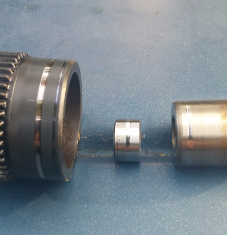

Incidentally, the bushing on the upper balance shaft 'was' expectedly shiny on the seal mating surface but my finger nail couldn't detect any ridge. I think I'll just pop it back in unless there is a shower of concern. :) Not sure if RMI has a fresh one or if it will stall my progress too much. Happy to hear feedback on that.

Upper balance shaft sealing surface: mine was worn, and I should have bought a new one, but I cheated and installed the old one backwards. You lose the chamfered edge which is supposed to protect the seal, but I just wrapped the sharp edge with PVC electrical tape and used oil when installing the seal. It hasn't leaked yet...

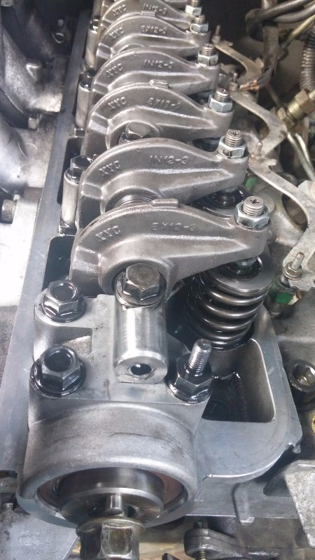

Correct me if I'm wrong but I think I might be looking at a relatively new head in here? I'm accustomed to baked on oil on the valve springs and keepers. These are clean and crisp...

Oh, that is totally a new head. XYC brand rockers are the clincher, but there's no way something that pretty is the same age as the rest of your engine. ;-)
It's safest to replace the sealing surfaces, if you have time to wait for new ones. Those look a little too worn for my liking anyway.

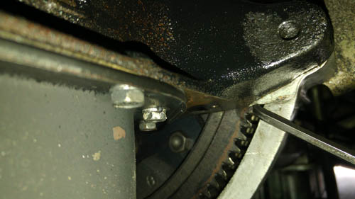

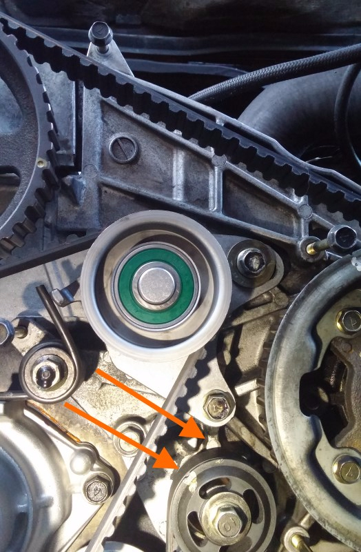

I've just had to replace my water pump (grr) and took a couple of photos that might help you when reassembling-
Locking the flywheel: if you remove the sheet metal cover between the bellhousing and the sump (four 10mm bolts), you can use an allen key to lock the flywheel. it fits nicely between two starter ring gear teeth and jams up against the bellhousing. This photo is of the left side for undoing the crank pulley bolt- for tightening you'd obviously put the allen key on the right side.

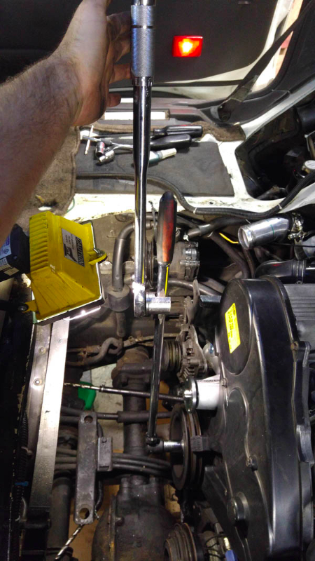

My torque wrench doesn't go to 180Nm, so I've attached an old socket to my breaker bar. It's the same distance from the breaker bar's end as the torque wrench is long, so it effectively doubles the torque wrench's length- which doubles the torque wrench's torque. So to get 180Nm at the bolt you'd set the torque wrench to 90Nm. Like so:
