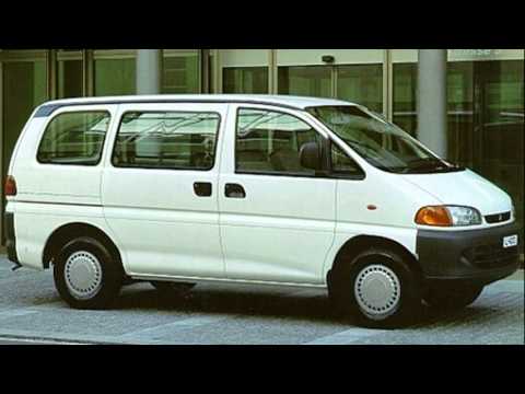

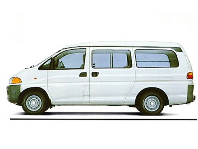

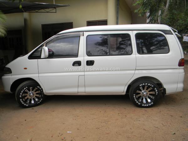

Nope, that's a high roof (without Crystal Lite). It's subtle unless you've got two next to each other. It's easiest to spot with white L400s as they have the black gutter trim:
Low roof SWB- the roof hardly rises above the black trim, back windows are shorter than middle windows, sliding door ends 1-2" before the wheel arch.
High roof SWB- the roof humps up above above the black trim.
High roof LWB- humped roof, back windows about as long as middle windows, sliding door ends 4-5" before the rear wheel arch.
L300's have similar points of differentiation, but the high/low roof thing is easier to spot as they're squarer.
