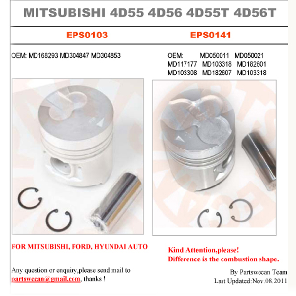

I was sure I knew, but I double-checked by looking up the parts listings- there are two pistons listed, 1988-'93 (MD103308) and '93-'99 (MD304847). throwing the part numbers into Google Image Search showed the difference between the two- here's the best picture I found, early (pre-'93) protruding valve piston on the right (obviously):
4D55 4D56 PISTON.jpg (206.98 KiB) Viewed 16759 times
Recessed/Flush valve piston----------Protruding valve piston

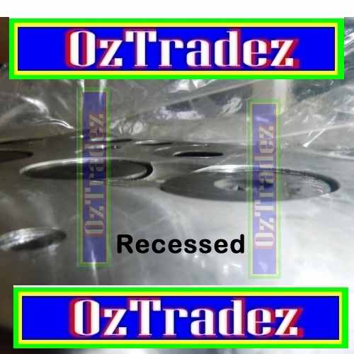

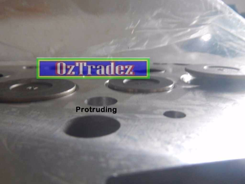

Here's what the two styles of head look like:
Pre-93 Protruding valves, uses the piston with the larger "cloverleaf" cutouts.
Post-93 flush valves, uses the piston with the smaller figure-8 shape cutout.
