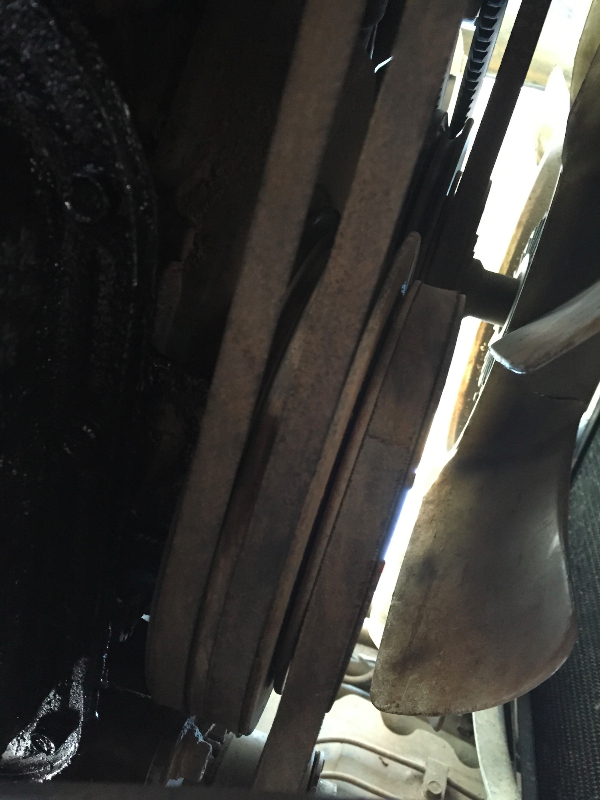

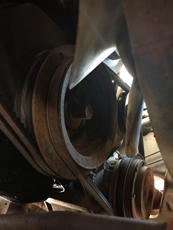

I checked out the pulley and it seems alright. It's tight and there doesn't seem to be any damage. Belts are relatively tight as well. See pics.

From your pics the pulley seems to be in the right place.
Loosen the belts and check that crank pulley with no tension on it. Put a prybar/long screwdriver between the pulley and the engine to test for excessive flex in the pulley. Don't go superman on the thing...gentle prying will tell you if the pulley is wrecked or not.
Is your EGR valve connected ? When its working normally the engine runs well but when they fail the engine runs awful and will often quit at idle.....they pop, fart, puff gobs of grey, white and black smoke.
Covering the ports with thin metal plates to block the EGR is one fix, pulling (and blocking) the vacuum line that activates the EGR is another method.
If all of this still proves no-dice then your motor may have internal problems which needs proper diagnosis by a tech who knows diesels. If you know of any tech's who work on small tracked Caterpillar equipment in your area chances are they have seen the MItsu Diesel engines....and by small I mean fit in your back yard to dig a narrow trench kinda small.

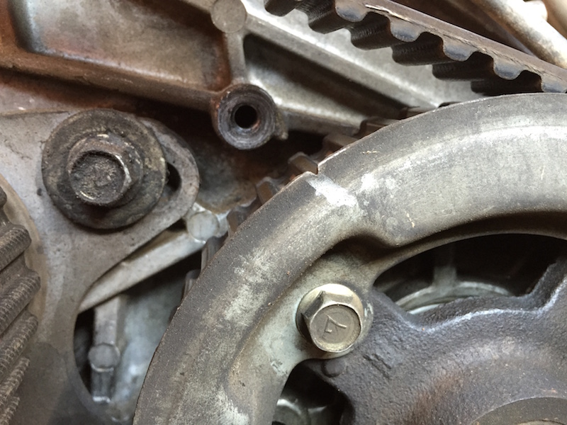

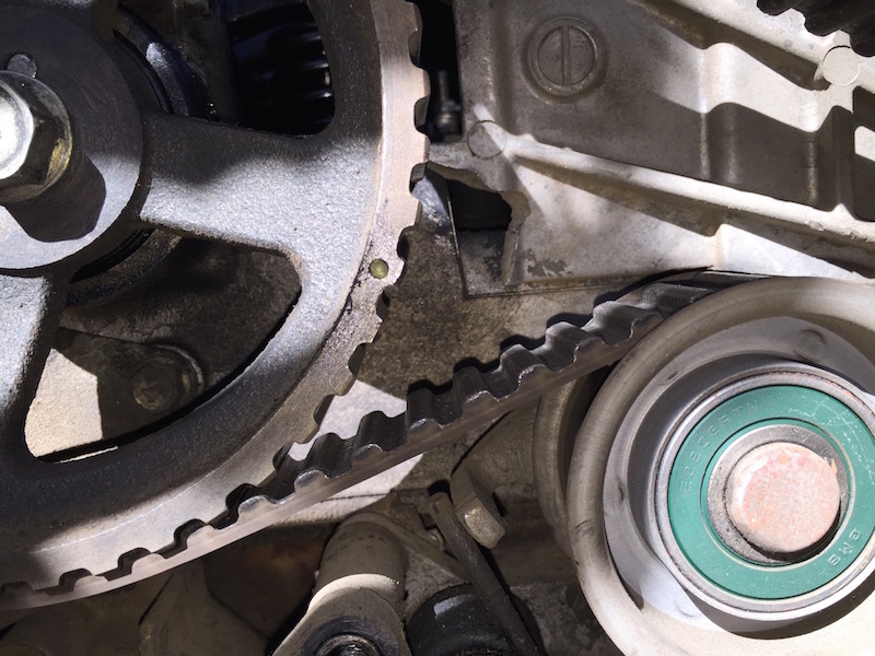

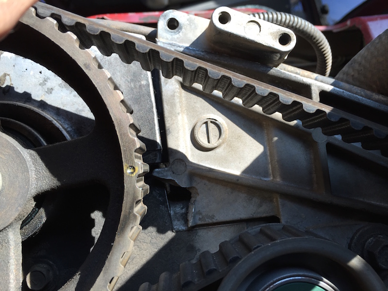

I was able to loosen the belts and check the pulley and it's as tight as can be. No wobble or looseness. To that end, all the belts and pulleys are tight. I also pulled off the timing belt cover to check the timing marks but turns out the marker piece is missing, broken off or something. See the photo. It's generally pretty close though.
After that, I had a mechanic (who has worked on a friend's Delica) come by and we checked the heads (good) and looked for metal shards in the oil, but found none.
Before draining the oil we ran the engine for a bit and he's confident that at least one of the cylinders is not firing. Below is a video. He thought it was initially a rod or crank bearing but since we didn't find any metal in the oil, he ruled that out. We are basically at a point where he says something is wrong but he has no idea what it is.

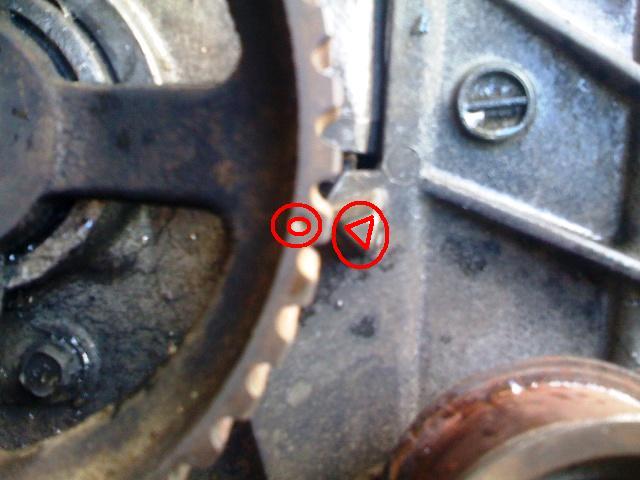

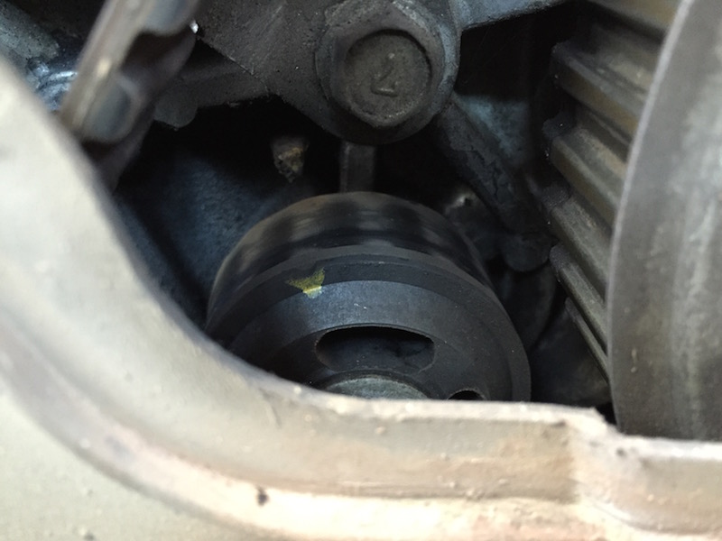

I think the timing is alright. See photos of all the marks.
I'm going to try and find a diesel specialist that can assist in removing/testing the injectors next.
Re: Loud knocking, shaking, then died on hwy...
Posted: Fri Sep 11, 2015 4:50 pm
by RickJ

Posted: Sun Sep 13, 2015 8:03 pm
by Growlerbearnz
Your camshaft is one tooth off in that photo- the timing mark (if it was there) would be pointing at the next tooth down:
4d56cam timing.jpg (40.85 KiB) Viewed 11360 times
The injector pump timing looks perfect.
Also, in the video, it looks like the timing belt is moving around a lot, like it was a bit loose. It's probably just YouTube's motion stabiliser trying to be helpful, but that top run of timing belt shouldn't flex hardly at all- there's going to be some vibration, but it should only be about a quarter inch. Of course with the engine running that badly the belt's going to be under a lot of stress.
To be safe, I'd be replacing the belts and tensioners, because they've been stressed.
