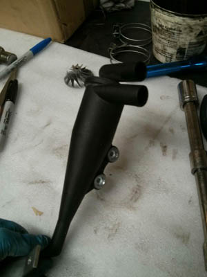

BMW use a centrifugal style oil separator on some of their cars, and it's a cheap part- I figured it would be ideal for my smoky van. Here it is from an X5:

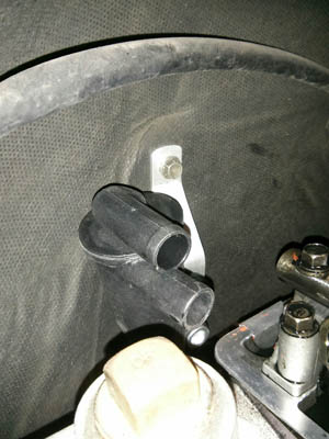

The neat thing is it is self draining- simple, I think, just plumb it into the dipstick tube, like so:

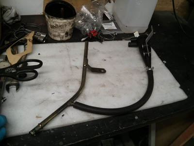

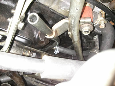

Here it all is in place:

What I didn't appreciate is that BMW have a very complicated PCV valve setup to balance the vacuum in various parts of the engine. I don't. Result? Oil was sucked up the dipstick tube, filling the separator, and flooding the intake manifold. Suddenly my idle speed jumps to 1500rpm (and climbing) and the exhaust starts blasting out blue smoke as it begins to run on its own engine oil.
This is called Diesel Runaway and it is very, very bad. I realised what was happening pretty quickly and turned the engine off, and it took a terrifying 5 seconds or so to stop- I was very, very lucky.
I think I'm going back to a regular, manually-drained catch tank.
Update: Or maybe not: the BMW separator works really well, so I've left it and plumbed its drain pipe into a jar, which I'll empty manually.
