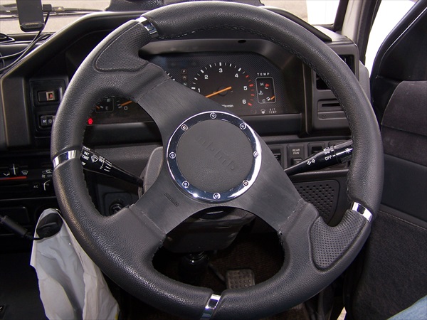

I have a complete original Steering wheel if you want it. I replaced mine with a real nice Chinese MOMO wheel in a nice Italian box.

I really want to replace my wheel this summer. How did you figure out which adapter to use? I have a L400 series 1 and can't find anything definitive for it.

The adapter depends on the type of wheel. Grant wheels use a different adapter than most other brand name wheels. The Grant adapter Part No. 3390. The Momo or other wheels use a 6 bolt adapter. An early 90's Montero will work. In fact from what I've seen most if not all Mitsubishi's use the same adapter. Ebay has lots to chose from.

There are also 2 bolt hole pcds for 6 bolt, at least 2, there might be another but 2 common ones, 70 and 73mm from memory. Generally adapters are doubled drilled for those 2. Ah yes there is also a much bigger old Mountney standard at around 100mm, but you are unlikely to see those over there.

lrp374, how much was the momo steering wheel? Did you need an adapter?

I think I paid about $60 for the wheel and about $15 for shipping on Ebay. I'm not sure if it is still available I'll try to find a record of the purchase. The adapter I used was http://www.ebay.ca/itm/191301353574?_tr ... EBIDX%3AIT again form Ebay. It is pretty cheap but seems to work okay. My old wheel is still around if you want it.
