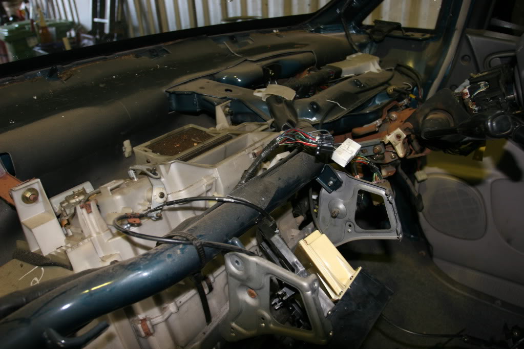

9.- On the dash right side side remove the black ECU screws, then the bolts that retain it to the bracket. Let it hang. Remove the white duct section on the left side of the AB. The AB will not come out without these two removed.

12.-With all that done the dash should lift. Gently lift the dash and brace it as high as possible woithout breaking anything. Pull up the large wiring cable above the round metal tube section. If the dash won’t lift easily more parts may need to be removed.

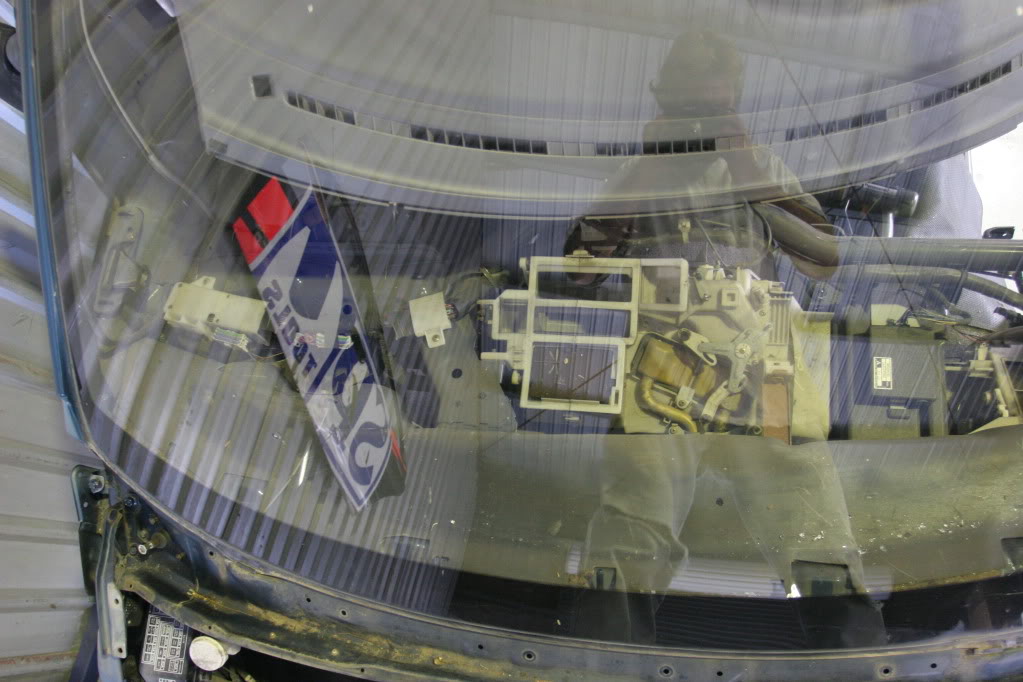

13.-Remove the last 3 bolts and the AB from under the dash and undo the heater core screws on the top of the AB. Repair or replace the heater core as needed and replace everything in the reverse order.
14.-Refill the cooling system with antifreeze/water, bleed the air at the vent under the hood and test drive. Check for leaks at this point. Have a beer and pat yourself on the back.
15.- Ocassionally check for leaks as clamps tend to loosen up after the job is completed.
This is just a guideline. Your application may be different and need more parts removed to repair/replace the heater core.
Some of these pics show the entire dash removed. They are just to show perspective and not to imply the dash need be removed.
