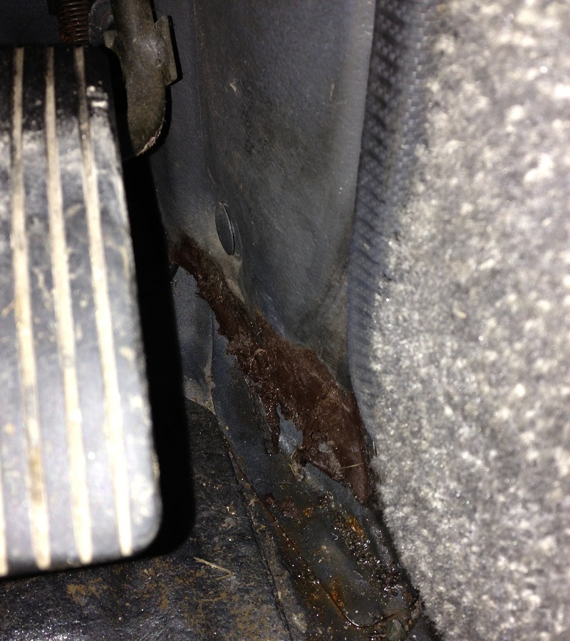

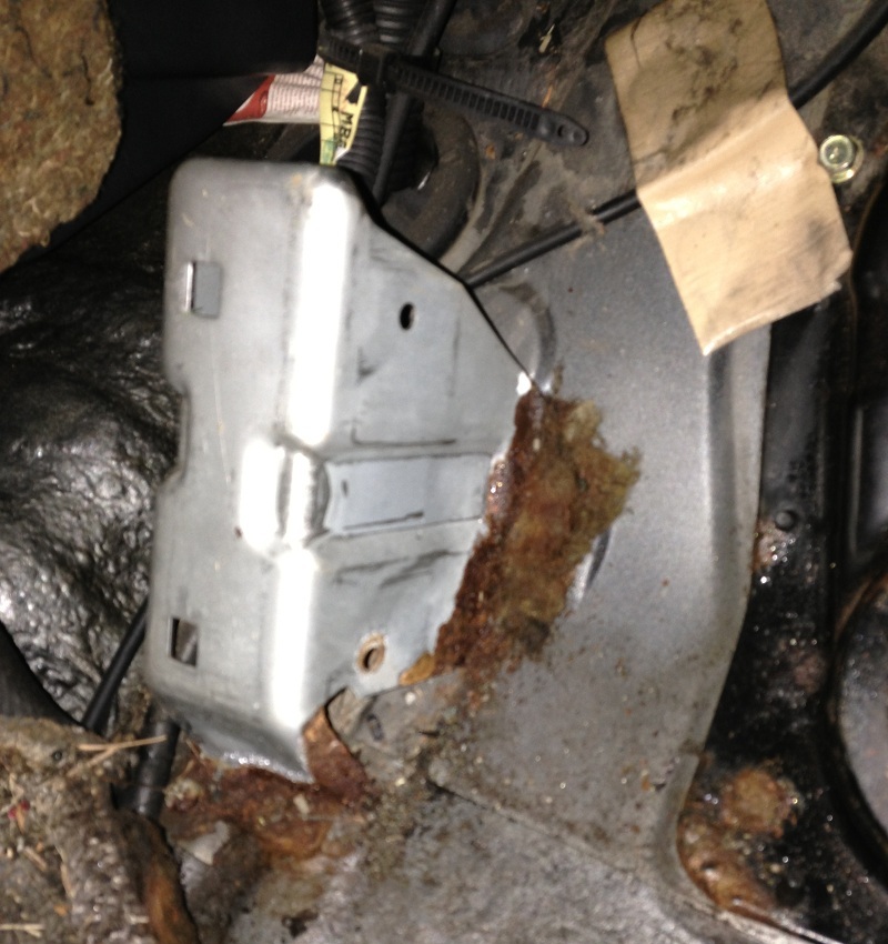

Wow thanks! Clips totally popped out. Now if only I could find a way to get the carpet out from under the cool box... It's REALLY wet and I have to find some way to dry it/clean it. (Might just have to cut around the cool box.)
- Side Rust
- Side rust.jpg (261.19 KiB) Viewed 2637 times
- Dead Pedal rust
- Footrest Rust.jpg (206.46 KiB) Viewed 2637 times
Re: Front Carpet Removal
You don't need to take out the cool box to get the carpet out. if you just rotate the carpet and pull it will come right out (it's just a thin piece between the shifter and the box).
