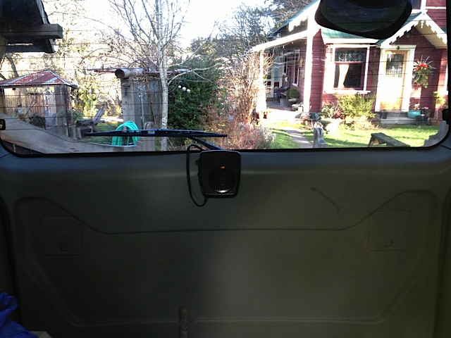

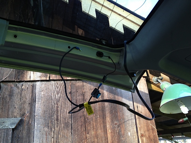

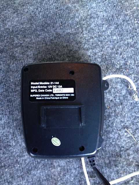

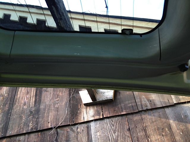

Got a little heater fan from Lordco , it's a little ghetto but it defogs the middle two thirds of the back window fairly quickly , it's wired to the existing defog circuit with an inline fuse too. the wiring tucked behind the plastic panels nicely . if I do find a cheap replacement for the back window I can restore to original.
