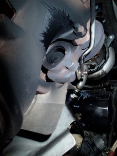

My van broke down :((( I am stuck in Helena Montana...So about 10 miles out of town last night I heard a loud noises followed by some sparks at the back so I pulled over and could not see anything hanging or nothing...WHen I started it again, it was running a lot louder, but everything seemed smoth, so I drove into town into the Walmart parking where I spent the night. With my panic, I also overfilled the oil so when I started this morning, I drove 100m away before I got some wicked smoke effect... Here is a picture of where it blew I think. HELP anyone....

You have somehow lost your waste gate cover plate. welding one on is not a good option. Don't think it is a serviceable part, may need to simply replace the turbo ( check first, as I have no idea) Your turbo is a td-04 9b( if memory serves... Chime in boys). I believe the dodge stealth 3000gt uses the same turbo (Mitsubishi eclipse etc..)

So it's been confirmed by the mecanic here that it is the turbo waste gate cover plate, so I need to source a new turbo, anyone can help with that?

The turbo is a Mitsubishi Td04-9b...this should cross reference as the same turbo used in some early 80's ford's and Dodge mini trucks/cars that came with the 4d56T (Ranger/Ram/Colt) The Stealth 3000Gt and the Mitsubishi Eclipse also share the same turbo with some small variances (actuator rod etc..)
TD04-7 Turbocharger
part number :49177-01500/02500(TD04-9B-4)49177-01501/ 49177-01310
OEM:MD168053
A good shop/mechanic should be able to source you one in a few days... you can get one through Rockauto.com/Ebay if all else fails. Should run you be between 500-800 complete. The install costs will vary.(4-5hrs?)
